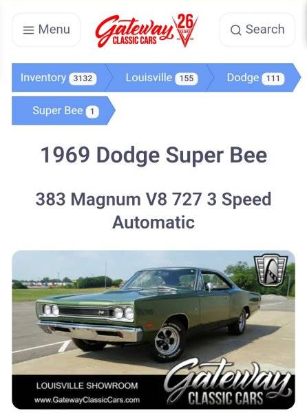

Gateway had a green 69 bee in the last year with them on it. You could see in the pics the wheels jut way out. I can’t say if it would cause a rub. Just a weird look on these cars.
i cant find that member to see the pics
