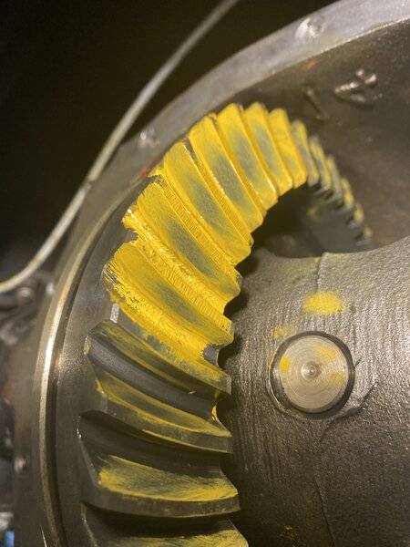

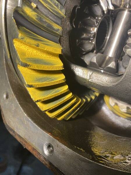

took a few tries on shims , but got it like this . went around the block a few times .
was spinning the tires .goping to take it on the highway tomorrow .had some other things to do on her. Today pissing with rain so she sleeps inside
