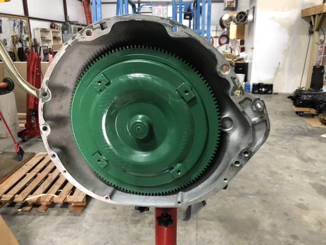

When I checked the torque converter, it still didn’t have fore/aft movement. So I pulled it out and sent it back to the builder. They said the hub was welded on wrong, fixed it and sent it back. It went on smooth and easily this time. I figured the incorrectly positioned hub caused the starter to break, and re-installed everything.
Engine starts fine the first time, no noise or grinding, and then breaks on the second attempt. So now I think maybe something wrong with ring gear. So I buy another torque converter from another company, and when I remove the original one, everything seems fine with it.

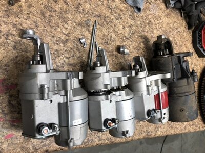

Here’s the starters, left to right, first one broken to last. Then a stock for comparison.
Note that on the last one, the upper bolt hole never broke, only the snout.

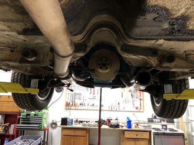

Was going to mention flex plate might be be backwards on the crank, but pic looks like it's correct. Sand the paint off the converter hub so slides in properly. Be sure it is engaged all the way in the trans pump lugs. The dowels in the block that locate the trans could need some adjustment, seems unlikely they would be that far off. Case could be deformed, again unlikely. Wrong size of the ring gear on the converter seems most likely. Might think about another converter manufacturer.
I'd check what dvw said first. Put a mini starter in, the nose of the didn't go in trans right. Had to rock starter to get alignment in trans. BeaterRus' idea trans case not aligned right, maybe. When you cranked it over did the sound of the meshed gears change?
Years ago we had one mini starter that required grinding on the block so it had clearance to mount flat. Also back the timing off if you think its kicking back, check tdc maybe your timing marks are off. I am not a big fan of mini starters, if a old school one fits try it...at least it won't be as painful if its breaks. We are still running a oem starter on our 510 rb...25 + years now...same starter.
Pull your plugs out and crank on it...it should crank really fast then you can likely narrow it to the engine or a flywheel engagement issue.
To answer some questions, all 3 starters were broke using the same torque converter. I have a different torque converter in the transmission now waiting to mount to the engine. Due to headers, I have to put the starter in place before mating engine/trans.
I have compared both torque converters, and their measurements are identical. I’ve spun them both while mounted in the transmission and they appear the same. Their teeth count and diameter are the same.
