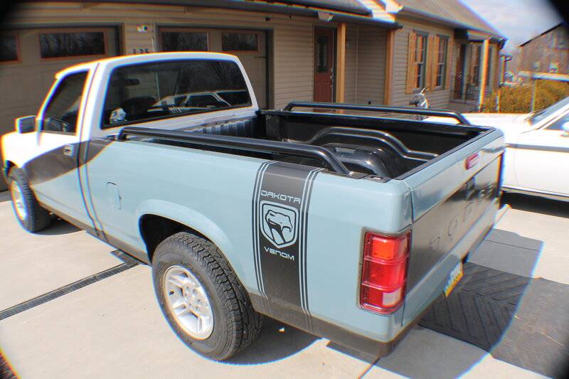

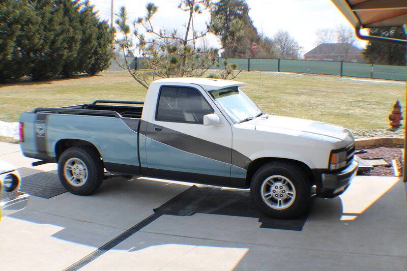

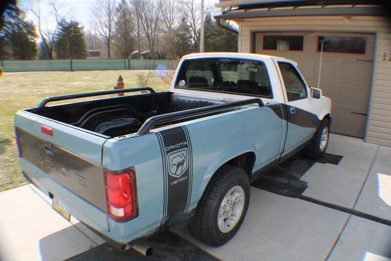

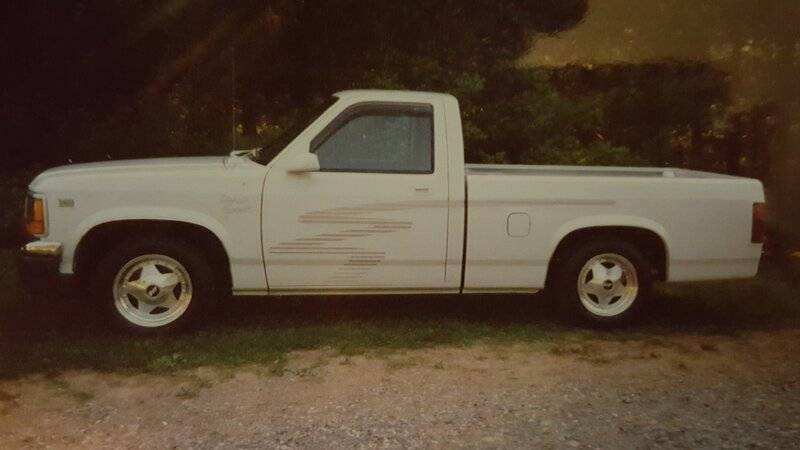

Just got the Dakota done after 3 months.
Needs some tweaks but passed inspection this morning.
3.9 5 speed with Air.
Very nice!! Well done!!

Nice 93 Dakota, looks like it had 98-99 wheels
You could be right. I got them at a local yard, I thought they said 2002, 15X8's.
I did not like the 93 wheels. They were is great shape with good tires and center caps.
Probably sell them at Carlisle this year.
Nice! I have the same wheels on my 95 and 96 but can't get the stock center caps on because of the bearing caps stick out into the hole. What do you have on yours that allows what looks like the stock caps?
I only had to smash the caps in some and they clicked right on.
Looked at that when I put the wheels on my 95 many years ago but they looked like a lot of smashing would be needed. Might look around and see if I can find a couple of ones that are already dented up and see if I can make things fit. Can't use rim weights either and expect them not to hit the upper control arm during hard turns. Even took a grinder to the 96 a little bit....

I have the 97 alloys on my 92-different than the style on the OPs Dak.
I also had to grind the tip of the upper control arm and put a large fender washer on each stud to keep the weights from hitting.
