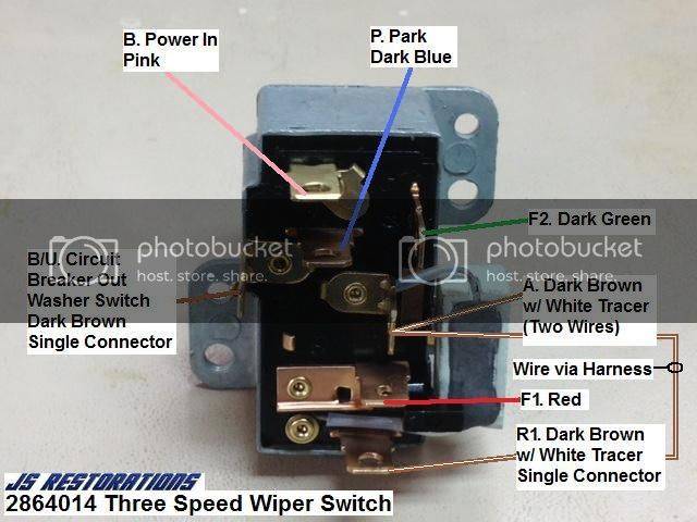

No, you need a 3 speed switch and the extra brown/w wire should be already in the dash wiring harness to use it.
How the switch gets wired is shown in this picture

My in dash switch does have 3 positions besides off. My bad.
With ignition key on I checked for power at firewall (bulkhead?) the terminal that connects to Brown wire had current, wiper switch off. Is this correct?
Pulled switch , no continuity between B and B/U in any position
