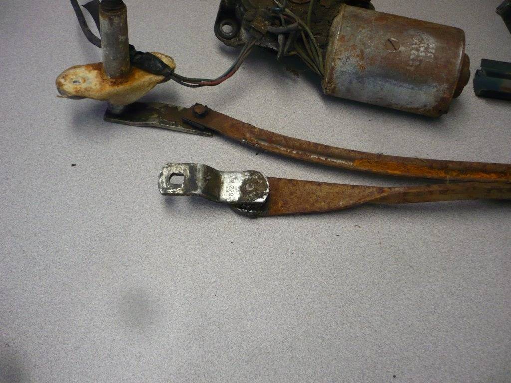

Just pulled of a 3 speed wiper motor from a 69 coronet parts car. I saved the connecting arms.
Are these standard or are they 3 speed only. Thanks,
The only "3-speed only" item is the arm and bushing that bolts to the motor.
Are these standard or are they 3 speed only. Thanks,View attachment 421367
I did the conversion on mine and the only part I had to find was the crank arm. hopefully you saved that. they are hard to find.
