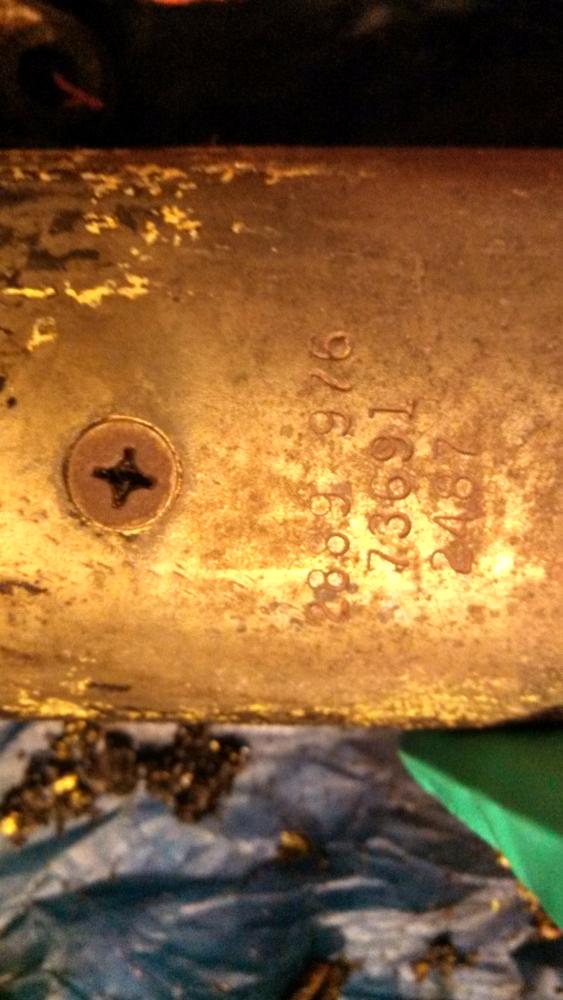

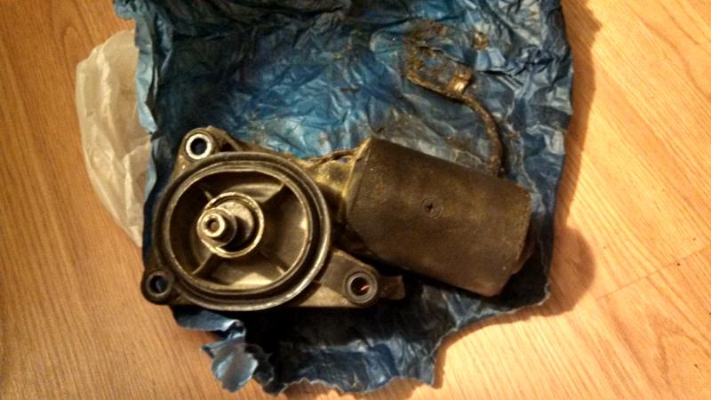

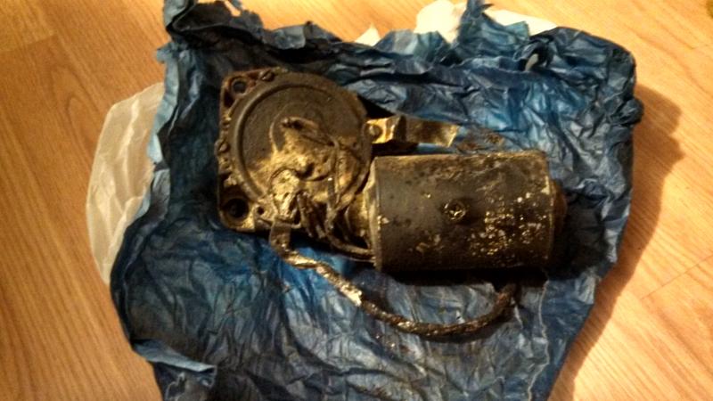

Started the restoration on my wiper motor today. After starting to strip some of the several coats of paint that have been painted on the motor over the years I was able to see the numbers on the wiper motor. It is a 3 speed wiper motor in a 1970 Roadrunner. The numbers that I saw on it were
Top line: 2889 976 Middle line: 73691 Bottom line: 2487
I am assuming the bottom number is a date code, which would be 248th day of 67 or September 5th from doing some research? And here comes the question part. I am assuming that at some point someone changed out the wiper motor with an incorrect year. Does anyone know what this would have came off of? Thank you in advance for your vast amounts of knowledge. It always greatly appreciated.
I can't find that number on my list but a google search has a couple hits that indicates it may be from a 67 polara. You may want to send an inquiry to passion4mopars.com they seem to know their stuff.
Thanks, that was my plan if no one here had an idea. I went to their site to look for the part number yesterday and was surprised to not see it there. I thought they had most every wiper motor there. I guess this one must have been a very shortly produced wiper motor or maybe a replacement of some sort. Didn't even see it in my B-body restoration book which covers all of the numbers.

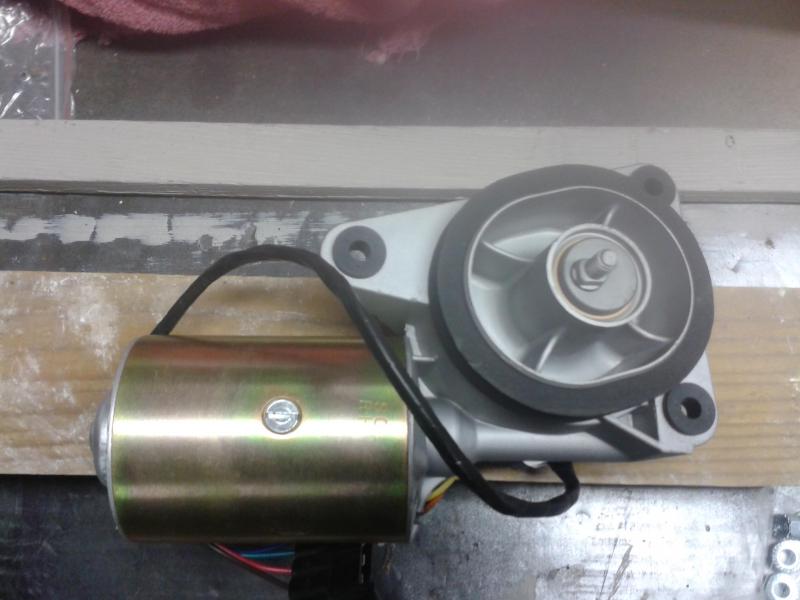

My 2nd wiper motor restored by Kim. As far as I am concerned, there is no better restoration service. This is the original wiper motor for my 70 Charger. It had suffered through a major underhood fire, but she saved it. Many thanks Kim!
