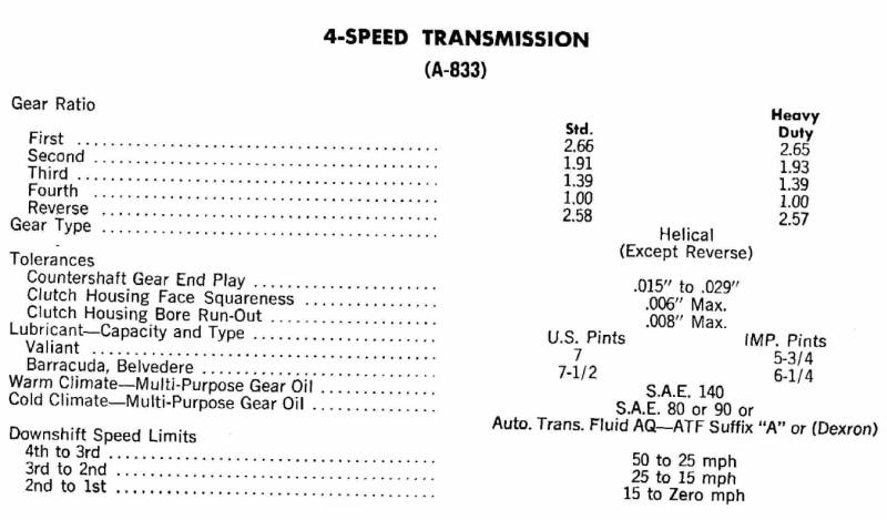

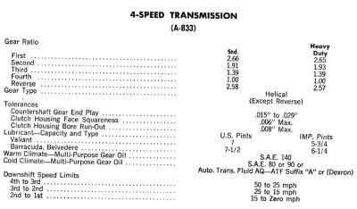

have a talk to jamie from passon performance or the guys at brewers.
passon has a special oil for there boxes, he told me the exact equivalent of it was a mix of atf and 85w-90.
he said 85w90 is too thick on its own and will sometimes cause shifting hardness, and atf was too thin to protect properly, so he said put 1 qt of atf in then fill the rest up with 85w-90, my box never shifted so smooth and when i freshened it up recently it was so clean i didnt need to touch it.
but ask the pro's if you dont believe me.
i am going to try your method benno440. is that what you put in your 68 Charger? Sounds like a good combination of thin and thick to get the gears moving freely : )
