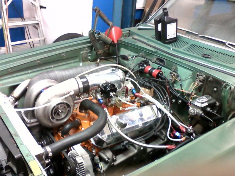

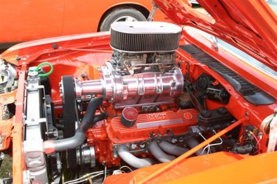

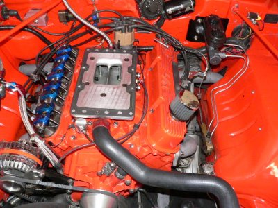

I've run a roots blown 340 since 1985. My manifold is a modified Offenhauser from Dyers. Studs and Felpro's at 12 psi will live if you don't detonate it. If you do and your lucky you'll blow the gasket. If your not lucky you'll take the ring lands out. Do not run much more than 28-30 degrees total under boost. That being said my sons turbo 360 with about the same mods at the same boost is at least .5 second faster.

Originally I ran the stock alt, water pump pulleys. We made these aluminum parts later. Boost is not boost. Roots is not a compressor, just a pump. Boost made by a roots is due to intake restriction and heat. They are pretty inefficient. My sons turbo car and mine weigh about the same. When we first put his together it was a near stock 360. Forged pistons and a reground factory hyd roller to .500" lift and bowl ported stock heads. 255/60 drag radials and a 2.76 gear. Running E85, no intercooler 750 blow thru carb it went 10.50@127. Mine has a 5300 converter, ported factory heads, .550" solid, 2 carbs. 11.0@123. We have since added Eddy ported heads and a .550" lift cam. 3.55 gear, 275/60 radials, cal tracks and good shocks. At 18 psi his has been 9.63@139.7 Currently we are turboing a stock 318. Installing the reground cam and springs from the 360. The rest will be stock (single plane swap meet intake and a blow thru carb). It's going in an A-Body we'll see in the spring how it runs.
