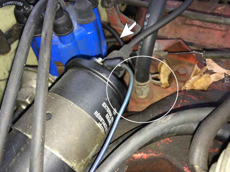

Circled is the vacuum coupling that attaches to the back of the intake manifold on my 318 Poly. The larger hose goes to the brake booster and the smaller hose (with the arrow) goes to the AC controls. The smaller nipple has broken off this coupling. If anyone has one they want to sell or knows where I can find one I'd appreciate hearing from you.

A picture of the broken piece would be much more helpful.
Braze it back on... You could also drill a hole where the nipple was, and put a longer tube in it, then braze that in place.
