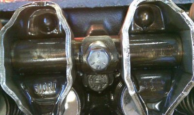

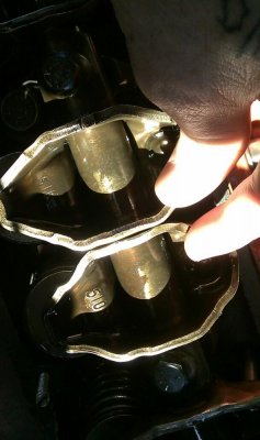

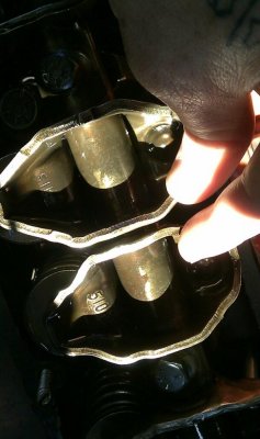

Ok, I just dug up a set of small block rockers, shafts and clamps. Looks like you may have the correct hold down clamps (I'm more familiar with big blocks) but they may not be in the right location. You should have long and short clamps. The short ones go on the ends with one short clamp in the middle and then the other two should be long ones. So, you should have short, long, short, long and short on each side.
