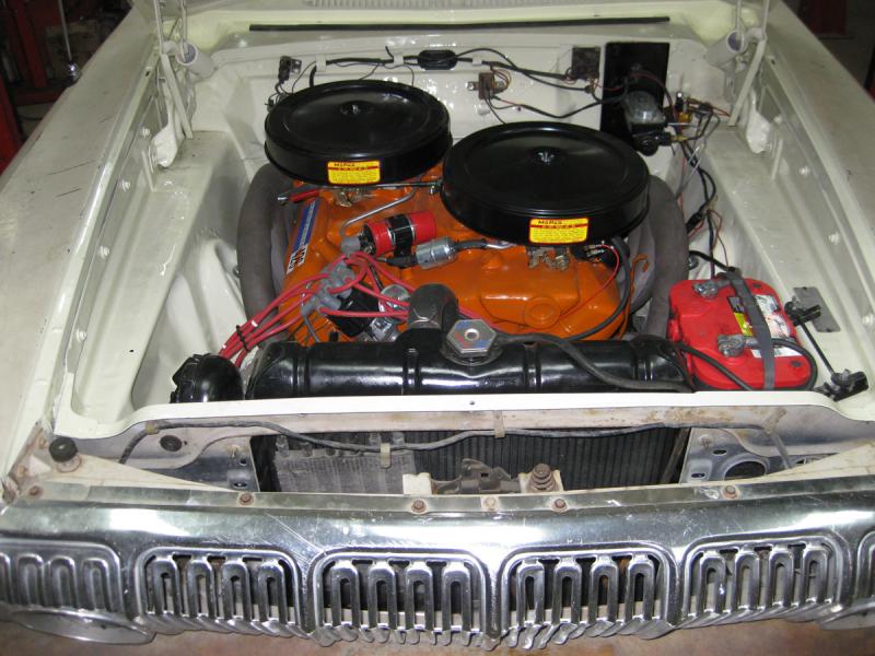

Make sure you have an after market temp gauge for accurate temps. My running temps with Aluminum heads and repro MW manifolds were 220ish while idling for long periods of time. 180 deg. thermostat. I think a shroud would be a good addition as well as a 7 blade fan.
This gives a stock look if thats what your after.
Just added to the harness like Cranky Said.....
