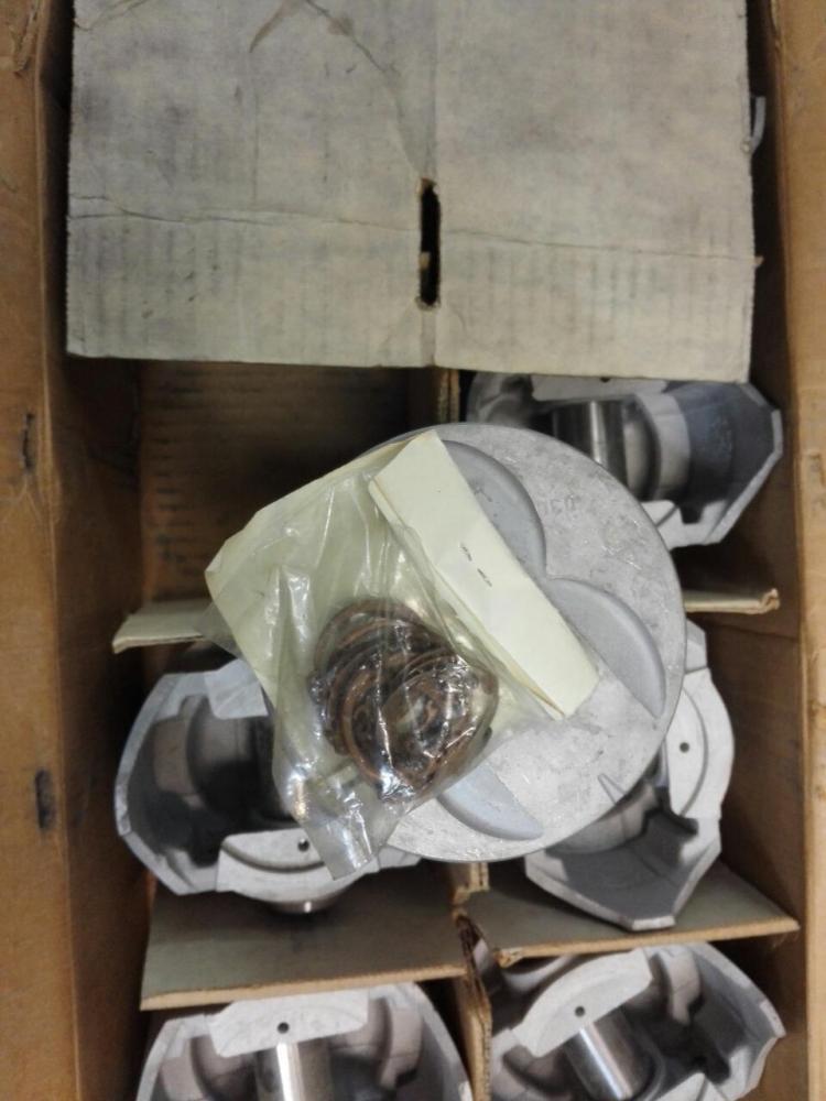

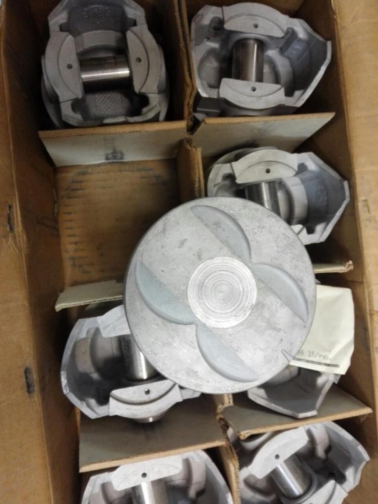

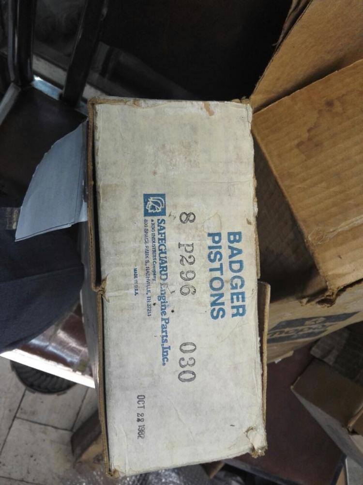

Hey, look what I found here at a local shop! New set of 030 pistons for 340 Engine from 1982!
These are from Badger pistons, safeguard engine parts. The shop owner is an old friend of mine and is asking 100$ for them. Do you recommend buying them for a stock rebuild? He seems to have the entire stock parts I need for my 340 and a relatively fair price. I can start my stock build right away.

Hey, look what I found here at a local shop! New set of 030 pistons for 340 Engine from 1982....
Yes!!! For a stock rebuild, no doubt, in a heartbeat flat.
I have used Badger Pistons before. There an excellent stock replacement piston. The first time I used them was in a 318 that propelled my '73 4spd Cuda into the 13's way back when I was still about 20/21. That was somewhere around '87....
FWIW, being a cast piston, they will drop right into my block or any .030, 340.
Thank you very much for your reply. I am heading to buy them now!

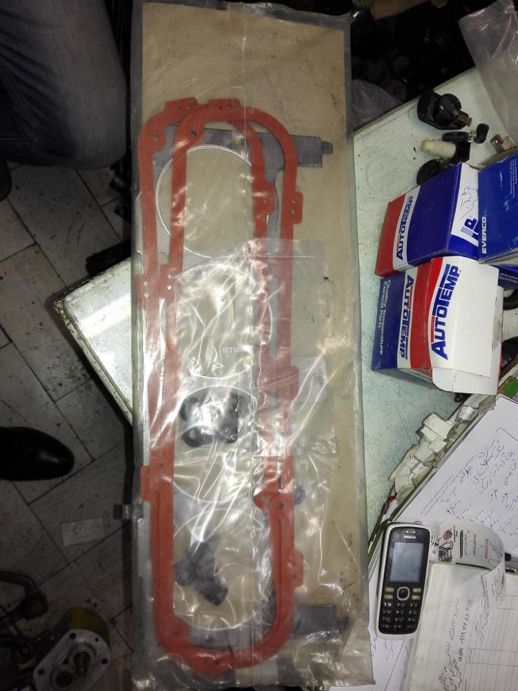

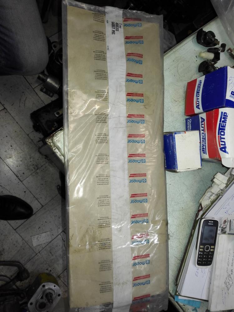

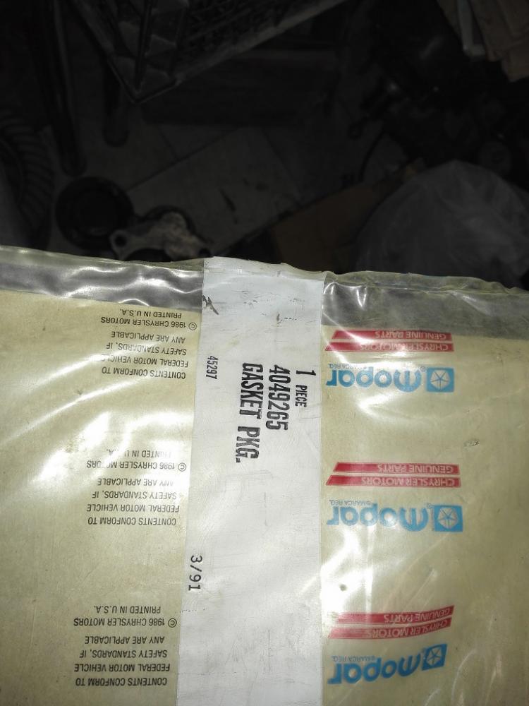

I also took those Badger pistons and ordered the other necessary parts including the 360 heads. Meanwhile, I couldn't find any Fel-Pro head gaskets here in Iran but could find original NOS Mopar gaskets:
Do you recommend taking these gaskets?

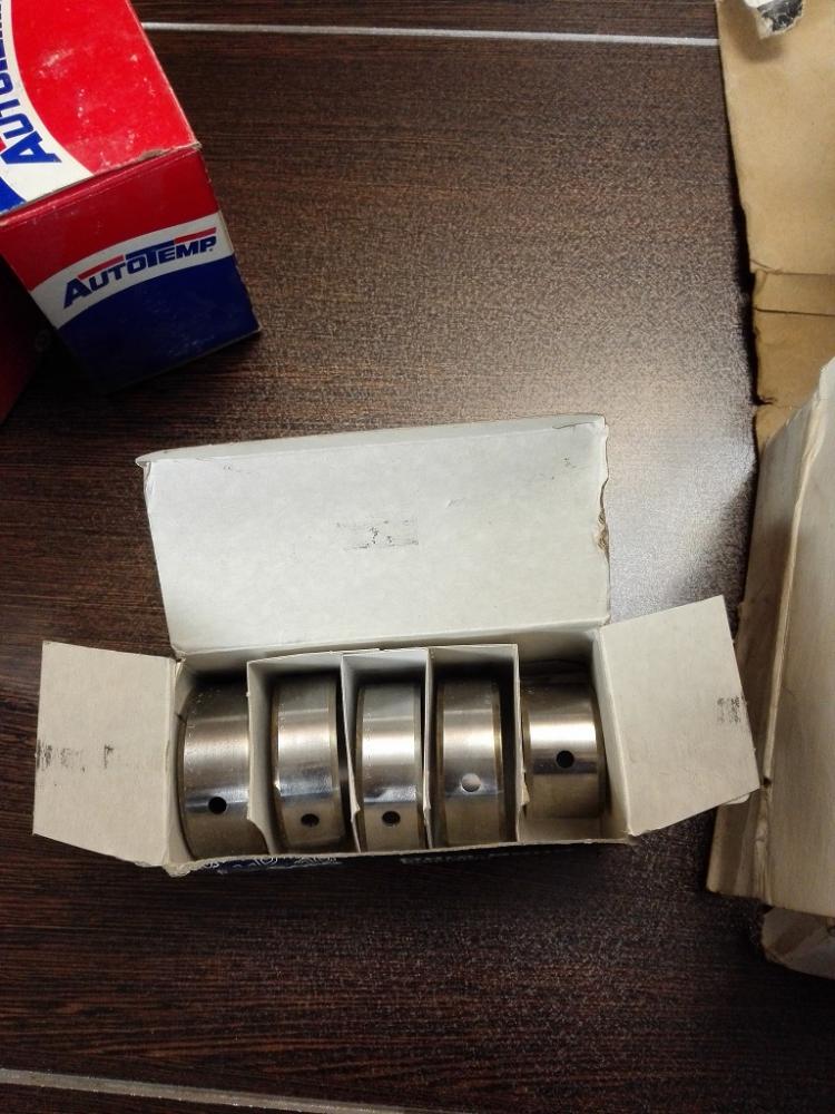

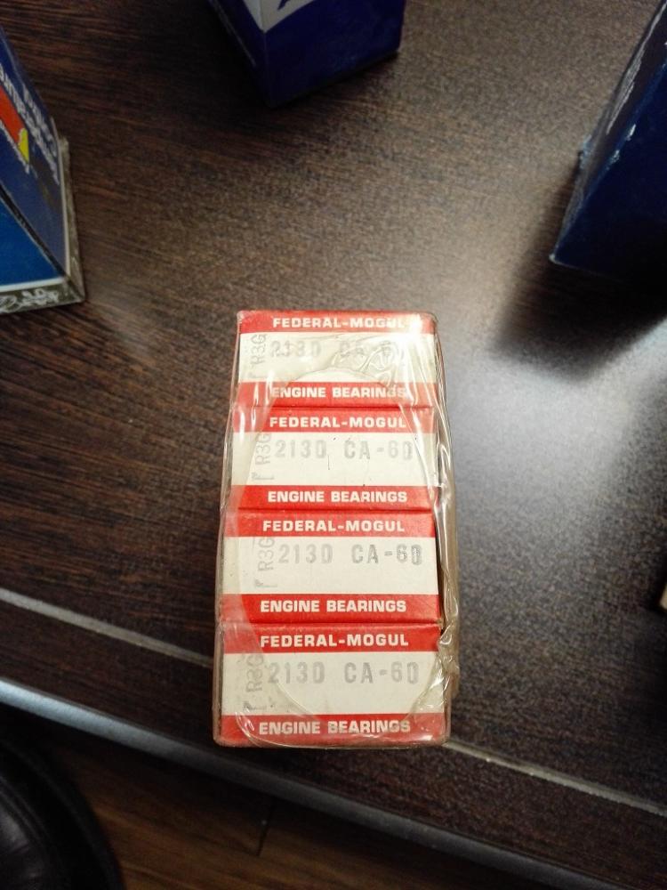

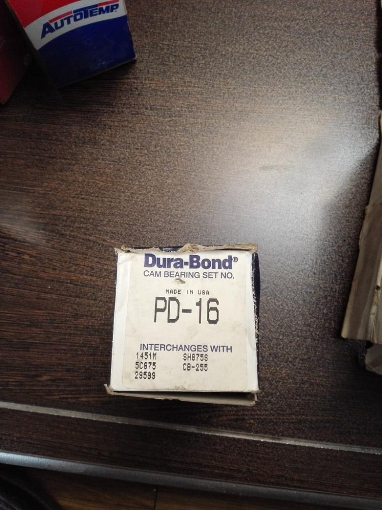

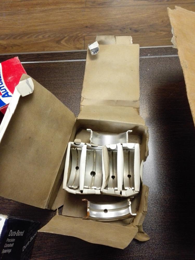

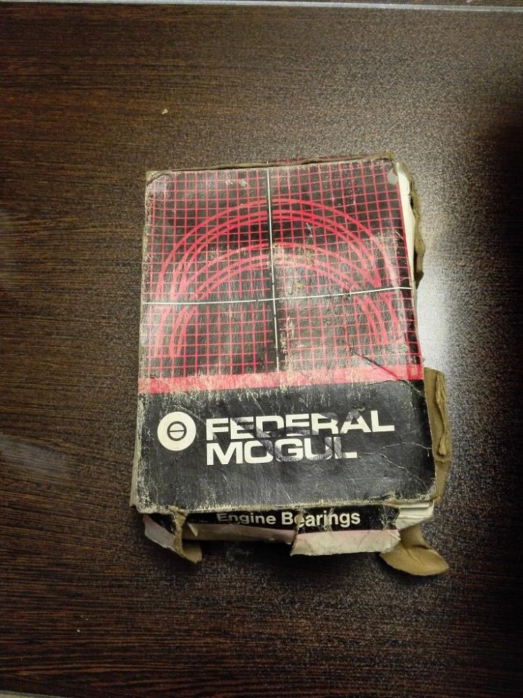

I got the new parts as listed below:
Main bearing
Rod bearing
Cam bearing

Thanks for your comment on pistons. Are they forged pistons? Do you have any idea about the proper clearance for them?

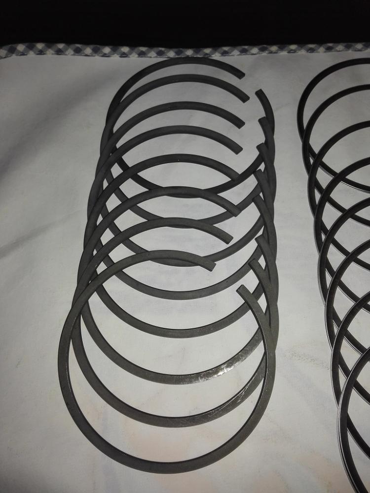

I got new parts today:

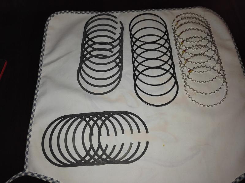

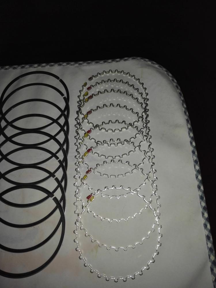

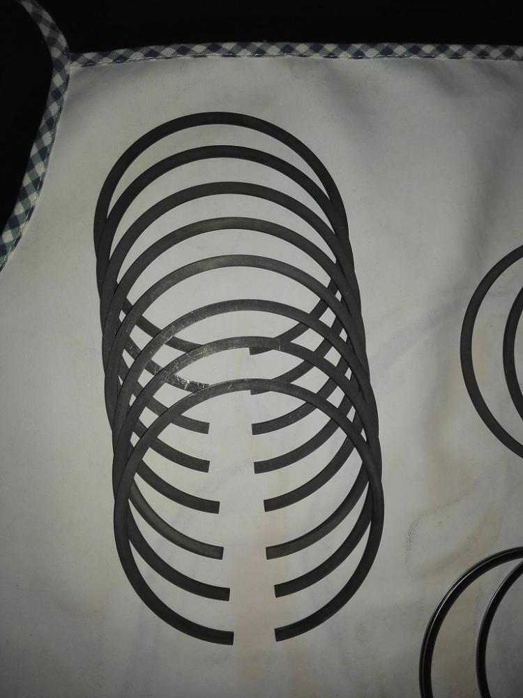

Piston rings, SEALED POWER. What are those red and yellow marks on the oil rings?

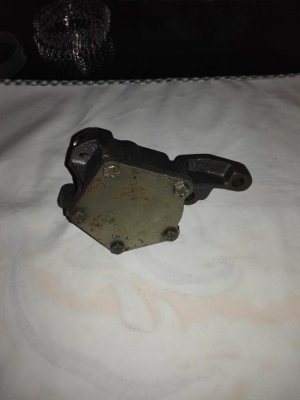

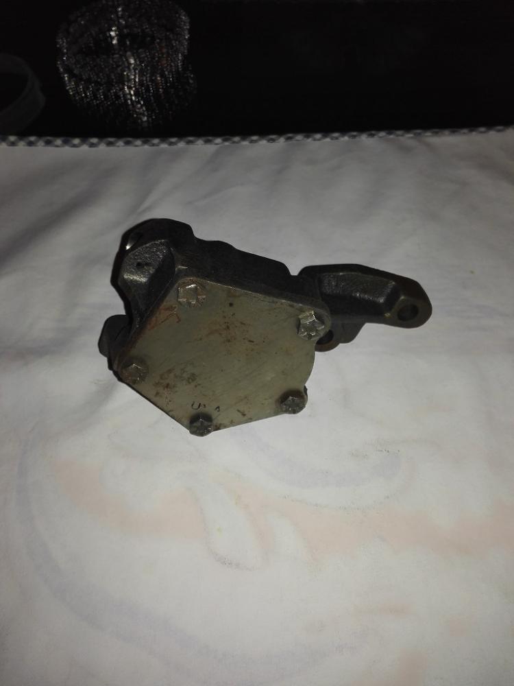

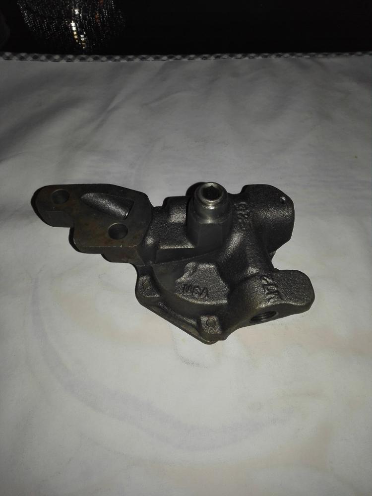

Oil pump with M72 number on the body. Is it the right pump for my 340?
Your comments are most welcome. Also, I am still waiting your feedback about piston to bore clearance.

The Badger pistons are cast and .006 is a lot. Will it work? Yeah, but if it were mine, I'd shoot for no more than .002"-.003". I'm thinking your machinist is playing it safe just in case he ends up with the bores out of round. Do you have other choices for a machinist? Also, I'm betting those pistons are low compression too. On the full floating pins....I like them much better and don't understand his reasoning on why a pressed fit pin is better for performance. So long as the rods are resized correctly and bushed for the full floating pins, it'll be fine.
Thank you very much. I kept my floating rods and had them rebushed, ready to install now. I do have other choices of machinists but this one is among top 5 in Tehran. The only problem is they dont have access to the documents. I showed him the book and we agreed not to go over 0.0015! Any comments on the rings and oil pump?
The block is now ground and honed to 0.0015" piston to wall clearance. I measured the compress ring gap and ended up with 0.018". Is this ok? Shall take my block away to start other works?
