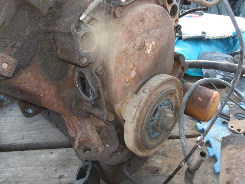

First thing to do,is to slide under the front and Look at the crank damper/balancer.
is it a cast crank or a Forged crank 440?
Dont lose your mind when you realize its a forged crank and he only wants 500 for the whole rv,or wants you to take it away for free.
some of your mopar buddies might scoff and tell you theres no such thing,but,ma mopar put these in the big class A rvs all the way to 79? i think.
you Have to look tho,Most are gonna be the cast crank 440s,this is not a bad thing,you are probably gonna go thru the motor anyways,the blocks are better if i recall,from 73 onwards. ( please correct me if im wrong there )
for those of you who say theres no such thing,i have a 1975 440 forged crank motor right out of a class A.
cost was 500 bucks.

thats actually the Best kind to find right there Rj,because its a class C van front,and the van guys can use all the parts to swap a big block into a van.
there are some major changes between the external parts used on a class a bb,versus a class c bb.
oilpan,pickup,motor mounts,exhaust manifolds,heat shields,and they locate the dipstick differently.
doesnt hurt that its free either.
