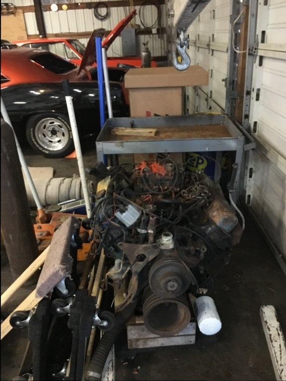

Anyway, found a local trade partner and looks like this is going to happen. He has a 74 440 out of a truck with only 40k miles on it. Along with that he is going to provide a new holly double pumper, intake, headers, 6 pack pistons and rods and odds and ends.
The 440 needs to be cleaned and gone through so I guess I am going to not only learn how to yank the engine and trans out the bottom but also how to build up a 440!
I was originally hoping to find a 440 that didn't need any work but this will be fun also.

FYI, The truck 440 accessories are different. The car 440's water pump intake is on the drivers side not the passenger side. I would not consider the six pack rods and pistons as anything special, they are heavy as F**k. Being a 74 truck motor, most likely cast crank and externally balanced, low comp, low hp engine. A 727 for a big block has a different bolt pattern than one for a small block. Do the headers fit your car?
What are your goals for building an engine up? Depending on your plan you may end up only using the block,
If your 340 was a good motor, you may want to consider keeping it. Depends on your area but that motor is most likely not worth much in its present form, maybe $500 if it runs well, $700'ish if comes with a 727 bolted to it.
You should consider the cost of thicker torsion bars for your swap as well, mounts ect..
