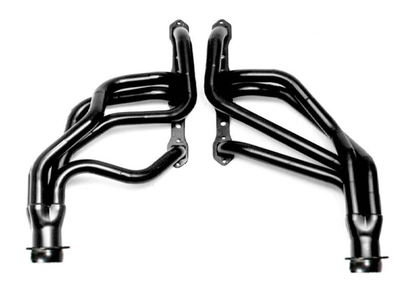

Big Block Mopar Tri-Y Under Chassis Headers
Schumacher Tri Ys . I bought a used set years ago they fit with no mods, easy install , good starter and plug access.
They were closed at one time but are now back open under new owners.
Cost is lower than tti,
I had seen a track test on them , better than HP manifolds but less hp than full length tubes.

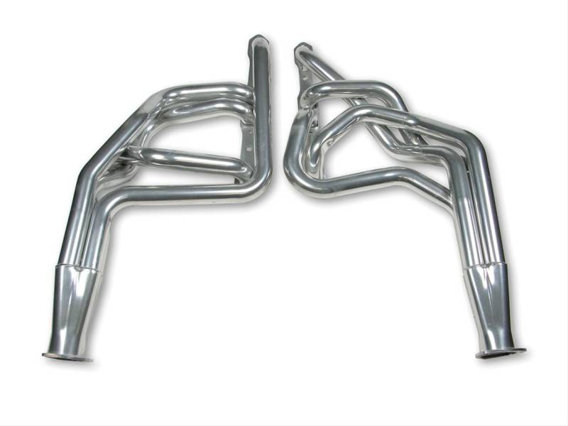

I don't know about nowadays, but over the years I have run numerous headers on my 67 coronets with a 440 and never any any real issues. Some were easier to install than others. You want a small header which helps. I have run those Hookers before but they are a little big at 1 7/8. The ceramic coated ones are a good deal!
No idea how good they are, but you can go real cheap to better:

Ya looking for 1 3/4 , yes this hookers are at a good price right now. The main thing is finding a header that fits without hammering on them. Read some posts on different forums and guys complaining about having to beat on their headers to get them to fit. They were all real old post like 10 years or more, so was thinking maybe they have been improved by now. Just what brands have been improved.
