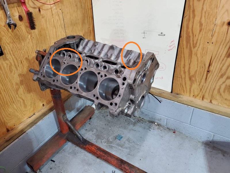

The block deck has the oil galley hole from the cam making it a LA block.

and because it is the LA style wouldnt that mean that it oils through the rocker shaft and not the pushrods? i thought the la oiled through rocker shaft and magnum oiled through pushrods

That block is a 85-93 LA ROLLER.... it's pretty much as good as it gets... can run a roller cam pretty inexpensively in it and it has the top end oiling holes like a normal LA

so just to be clear this would oil through the rocker shafts correct? this is the assumption i have been operating under from the start. not that it makes a huge difference yet because i havent started getting everything yet but it will make a difference soon.
Yes.. will oil through the shaft, i have the 318 version of that block in my car with trickflows and harland sharp shaft rockers...

This is you top end oiling hole right above the headbolt, the hold goes down to the cam journal.. Take a flashlight and make sure you can see light all the way through.. guys miss the holes on that bearing A LOT.... the second circle should have the same hold on the other side...
awsome that is great information. thank you alot for that.
