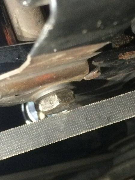

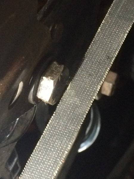

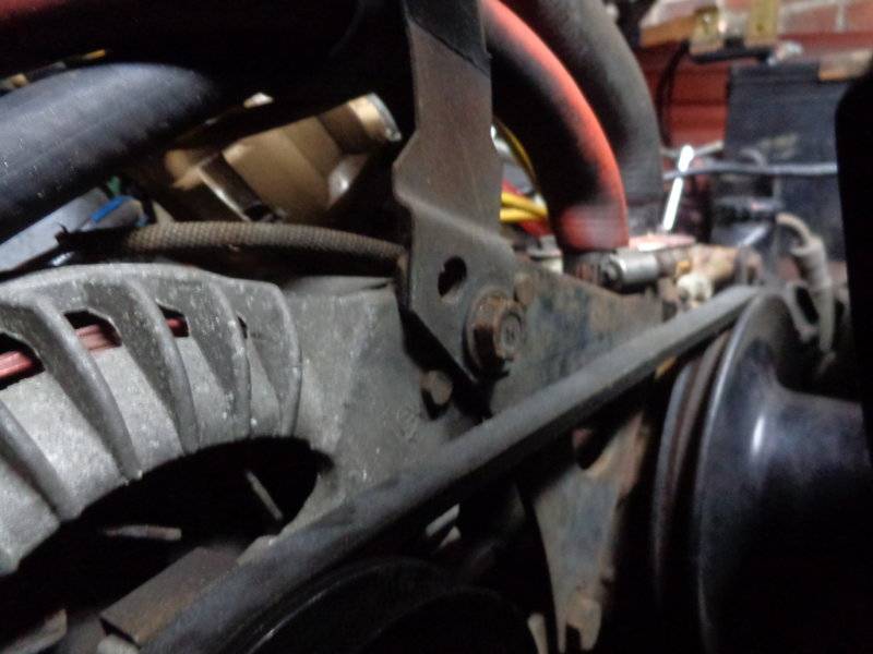

is it normal for the top alternator bracket bolt to almost touch the belt?
Here's mine
As long as it doesn’t hit bolt and shred the belt
If you use a shorter belt, the alternator would hang lower, the belts top horizontal section would be lower then that bolt head. Also then again two vehicles traveling at 95 miles per hour towards each other passing each other with only 4'' between them will still miss each other, but still scary.

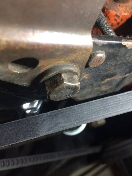

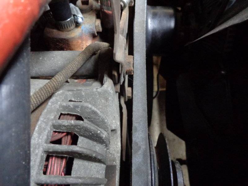

How about the bolt at the alt. bracket and water pump housing? Close to your belt also? Here's mine.

How about the bolt at the alt. bracket and water pump housing? Close to your belt also? Here's mine.View attachment 585251 View attachment 585253
What size do u recommend? Also will a shorter belt increase alternator speed?
You can take your belt to any auto parts store, have them measure it. Try an inch shorter, see what it looks like. Belt length has nothing to do with pulley speed, only changing the drive or driven pulley diameter will change the speed.
I see it's a cog belt, that's good. Maybe its just me, but save your tested belt and throw it in the trunk, it's nice to have two of some things with the quality of todays parts.
Good idea but I have way too many stuff in my truck already car show stuff and a small tool box etc.... hahahaha
