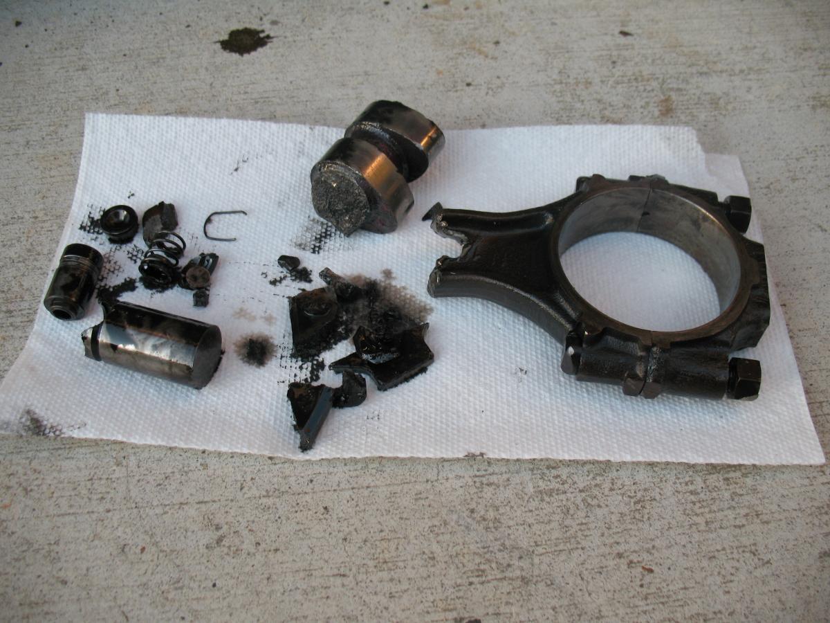

I am needing a little advice about a cam selection. I bought a 66 model 383-4 with the 516 closed chamber heads out of a Polara that had only 48,*** miles on it (really believe that is actual miles). Its runs like a top. I want to put it in the car (other motor broke conn rod and took out cam and block...uggg!) as a temporary "get it running, decent power, good sound and low budget" motor. I am planning on a full up stroker in the future but my main concern right now is restoring the body but I want it running in the meantime. I was hoping to use the 284/484 MP stick out of the old motor but the conn rod took that option off the plate. I know these arent good heads but I, at this point, dont want to spend any money working the heads over as they function fine for now. I want to clean it up, shove a cam in it, new gaskets and oil pump, paint it and put it in. I have some heavy valve springs off a 67 GTX 440 that I can swap over to the 516 heads to help the cam. (the heads on the busted 68 383 currently in car have set for 22 years with intake off and valves are rusted so I figure they are shot). It is a 3.23 727 car with 1 3/4 headers and Edelbrock TM6 intake. Really just want reasonable power and good sound. Having said all that, what suggestions do y'all have for a cam. I was considering a Lunati 60303 (3 bolt, which would require new timing chain set, I have a good single bolt set) or going back with the 284/484, or maybe the 474 MP cam. I've read as much as I can but since most dont mess with these heads, I havent found much info that is relative. Thanks in advance guys...
"So that is what that noise was?" :icon_cry:
