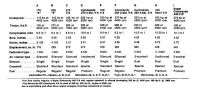

So here is what I can find for the '67 year. So I'd still bet that Fury you are looking at is a 383 as the 273 wasn't an option on the Fury's for '67 (the then new LA 318 was tho)
