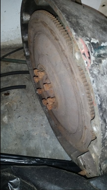

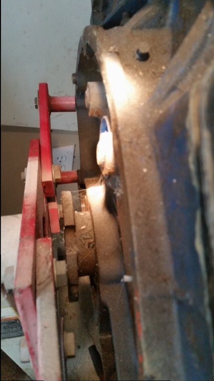

i forgot i never posted any pictures. Its sad when go to the machine shop with questions and he knows less than you do. He said i cant find a 383 before 1971 then i gave him the casting number and he said thats a 361. When i told him they used the same block for the 383 he said i never herd of that. Then i showed him these pictures and he said i never seen that before. You have to get the nuts in between the block and crank I didnt try but i herd its a bitch. You guys on this site are the only ones with knowledge.
That plug sticking out looks like it would be a problem if you use a regular crank.

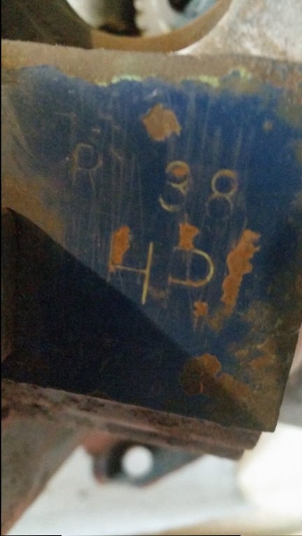

I am guessing that based on the stamping I thought it was a RB. But based on the casting numbers, 2128854, its a 1964 B. I cant explain how or why it got married up to a 1961 crank and transmission. This happened before I was born but my dad did tell me it had some machine work done. Here is a picture.
What you have is a pre '62 low deck ("B" Block) 383, it uses an extended crankshaft, the flange bolt holes (6) are NOT threaded and you can only use the cast iron torqueflite transmission or a standard transmission , flywheel, and flywheel housing for pre '62. The crankshaft is the ONLY thing different from a '62 and later 383.
Get a '62 or later 361 or 383 c/shaft. It will have 6 threaded holes in the flange. The stroke will be 3.38. If your '65 transmission is for a big block, it will bolt up provided you use the proper flexplate/ converter combo. By the way your '65 cable shift transmission WILL work with pushbuttons.
