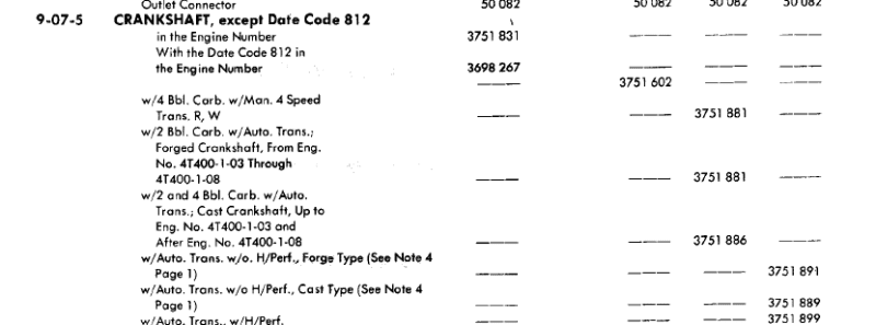

The number 3751877 is well into the 1974 range. Based on that I would think it is a 400 crank most likely 74 or newer. This is from the 74 parts manual.
YES, that is what I needed. I thought a casting number starting in 37 would not be a 70 or 71. Thank you for the help. Now I think I can proceed. I have lots of 426 Hemi data but that doesn't help me if I'm working on a 383 from the 70's.
