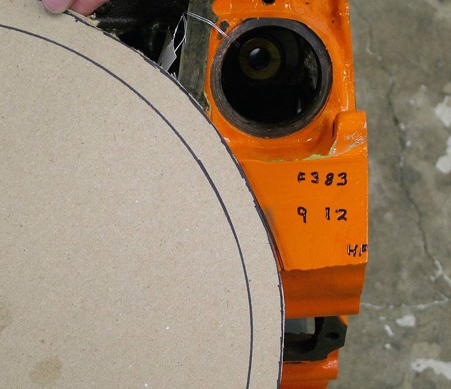

A couple photos to illustrate the process. The cutting head used for decking a block is about 12" in diameter & if it is allowed to travel the full length of the deck on the passenger side of the engine, it WILL wipe out the stampings on the "B" engine pad. Below we used a cardboard cutout to simulate the size of the cutter and make a mark on the block where we wanted to stop the cutter to preserve the original engine stampings but ensure that we still decked far enough to clear the cylinder head when assembled.
