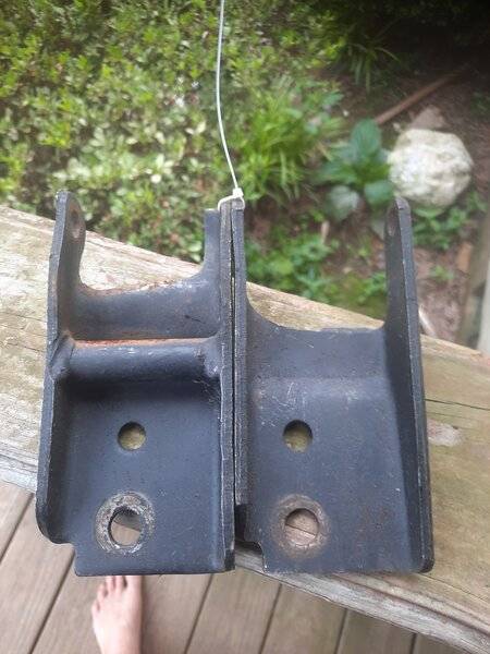

Which one is driver side which one is passenger side. Having an issue getting this Motor in.

The one on the right in your pic is passenger side.
Those are standard mounts for big block late 60s muscle cars. The one with the "tube" welded in goes on the drivers side. Actually they only fit one way, when installed properly the mount ears will fit up against the block ears on the register side without additional gaps.
Those mounts are 1966-1972 all B C and E
body. Drivers side has the tube.
...and they hurt bare feet.
