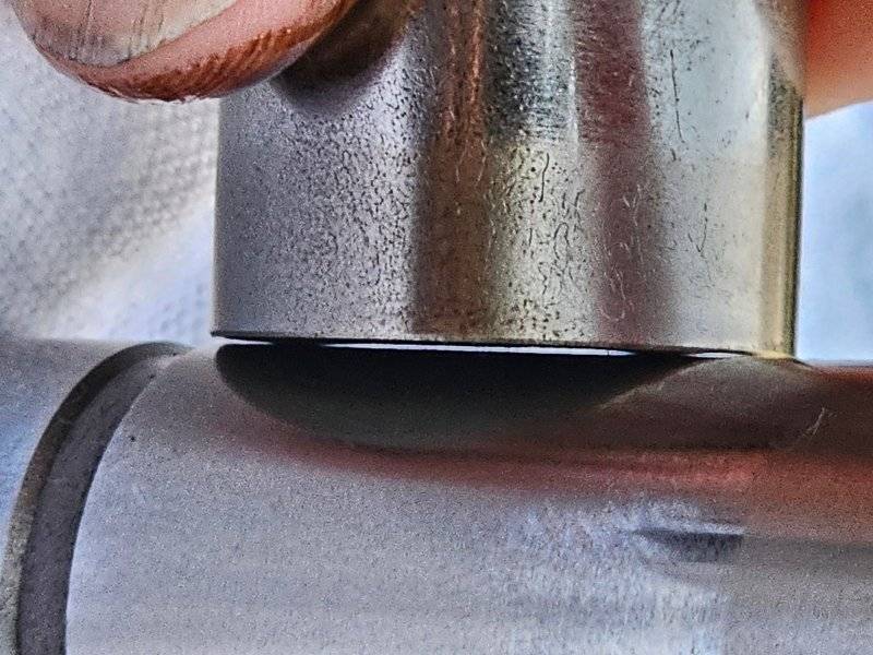

Here's the lifter

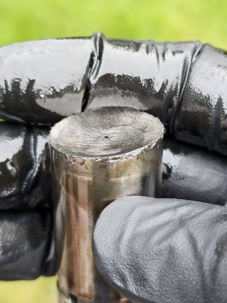

Here's another lifter. It's starting to concave, but still looks like the others visually. Smooth with similar wear pattern, but the others are still convex.

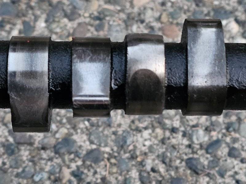

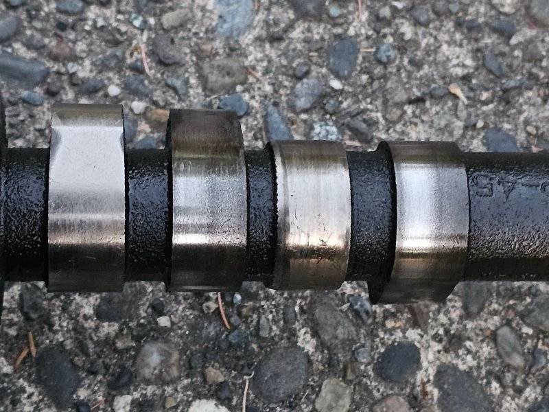

The Parkerizing is worn all the way across on the flanks, and most of the base circle on that cylinder, far left. The flat lobe is third from the left.

Any idea how many miles that cam has on it?
In light of the extra low CR of that engine, what are the plans now?
Shove a cam in it and hope for the best and keep driving it while building a “better” short block?
Or ??
I was estimating about 15,000 miles on the cam. I have a stroker motor for the car, but wanted to put this motor in my Dart. I found the original cam and I numbered lifters, so for the price of a couple gaskets, I'm going to take a shot at putting it back in. I tell you, although I'd rather not have a flat cam, it's amazing how easy and fast everything comes apart when it doesn't have 50 years of rust and crud on it.
