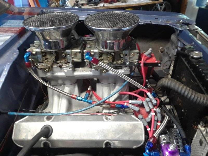

Just got done finishing up the Holley 750 installation on our Tunnel Ram equipped fire breathing 496. Will be transforming this into a 512, or another 496, due to there being excessive ring blow by in this 496. The reciprocating parts, crank, rods, roller cam and heads will all be re used. If I use the 400 block I have on hand, all I should need is new pistons to match the bore size, as well as the other bottom end parts, rings, gaskets,
etc. Here are a few pictures of what it looks like now. One more trip to the strip this year, to see how it runs with the 2 Holley 750s, then we'll pull it out, tear it down, and go from there.
