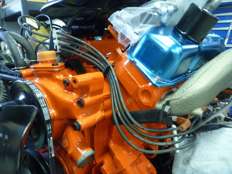

Stock manifolds?, headers?, expecting correct straight and 90's off the cap? Lots of variables but my Partsmonkey set worked just fine..
yes, stock manifolds. Currently has 90's on the plugs and 90's on the distributor and seems to work well but i can be convinced otherwise. It seems to me the 90's on the plugs would work better than straight. Most I see that say "correct fit" have straight boots for the plugs.
