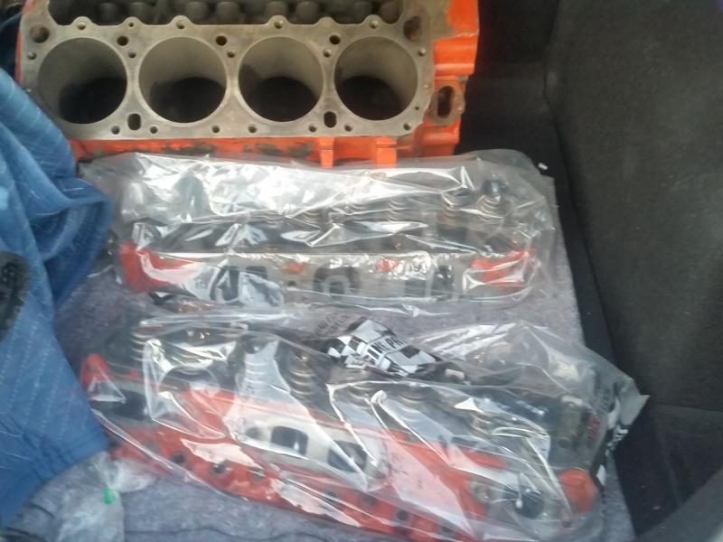

Got my block. The shop says it was magnafluxed, given a "rough bore" to clean up the cylinders, and line honed. The builder suggested I get a final bored (060) with a torque plate, line hone, and get the block decked.
Heads are 452s they are ported and polished. They said I should go with a solid roller cam with a half inch of lift.
I have the stock crank, rods, and pistons. The pistons are junk.

Stock 452's were 90-92cc if untouched, did the shop do any milling or just clean up the head surface?
Piston choices suck for 383, If you do anything with the block I implore you to minimally have zero deck height. You could even could go over deck due to how large the chambers are, a qualified builder could do the mock up for you and tell you what the compression would be.
