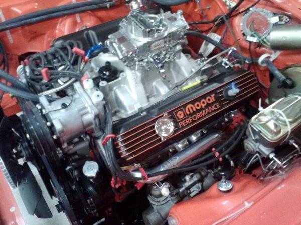

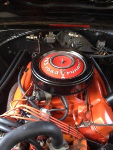

Zipties man zipties...
R&M Specialties makes really nice application specific looms. AKA other than Chevy only. You can get different colors and the best part is the insulator/separation blocks are made from a plastic. Nothing is as dopey as separating your wires to cut down on crossfire issues then hooking them together with metal blocks.
I went with the R&M Specialties Wire Looms and they worked out great. Thanks!

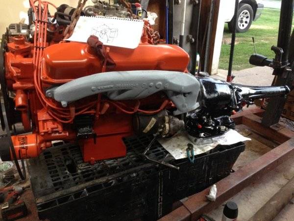

I'm using the factory HP manifolds and they sit really far above the valve covers. I'm concerned how the r&m loom will mount and get it above.
