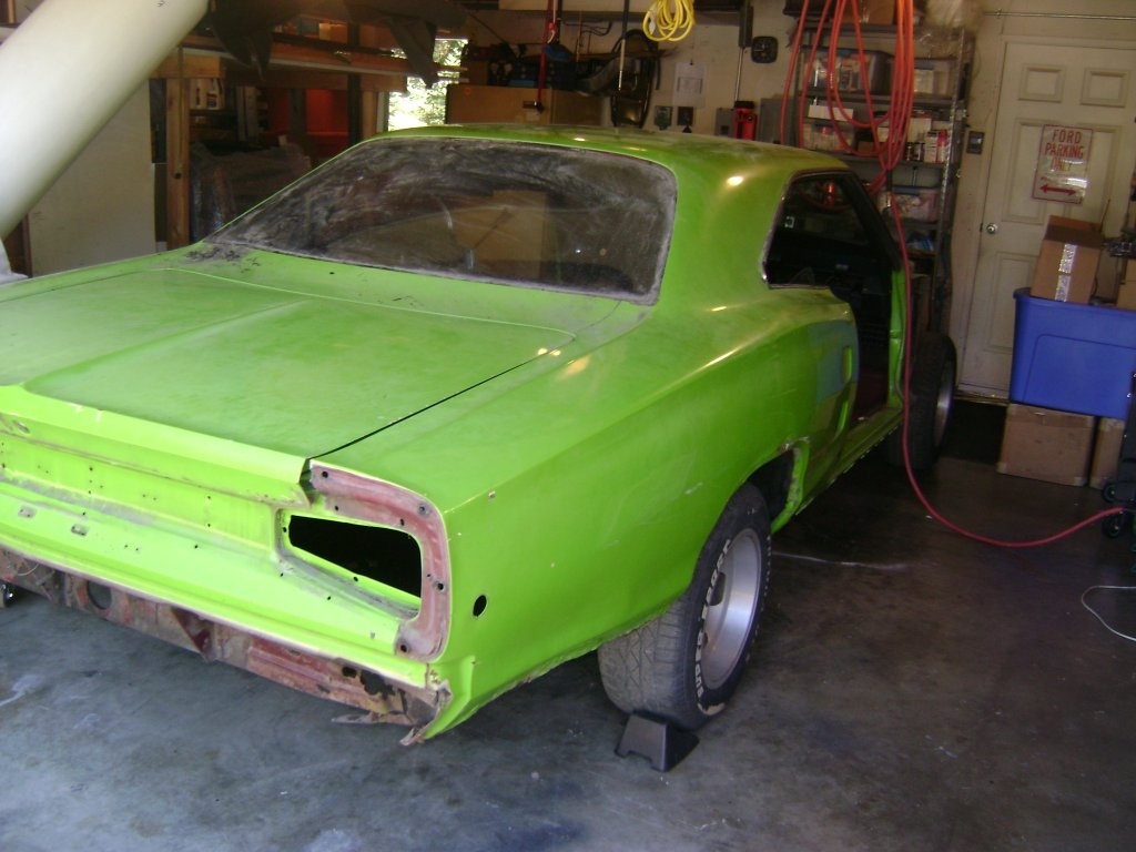

The home for this engine will be my '68 Coronet, which is now down to a bare shell.

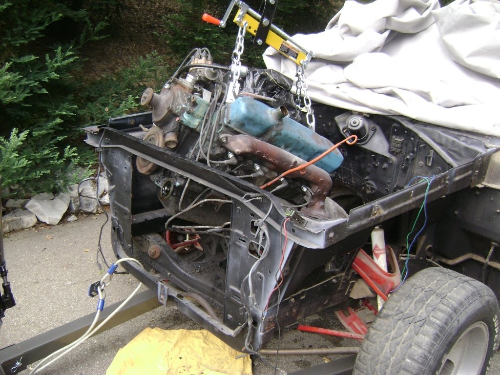

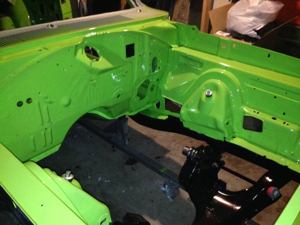

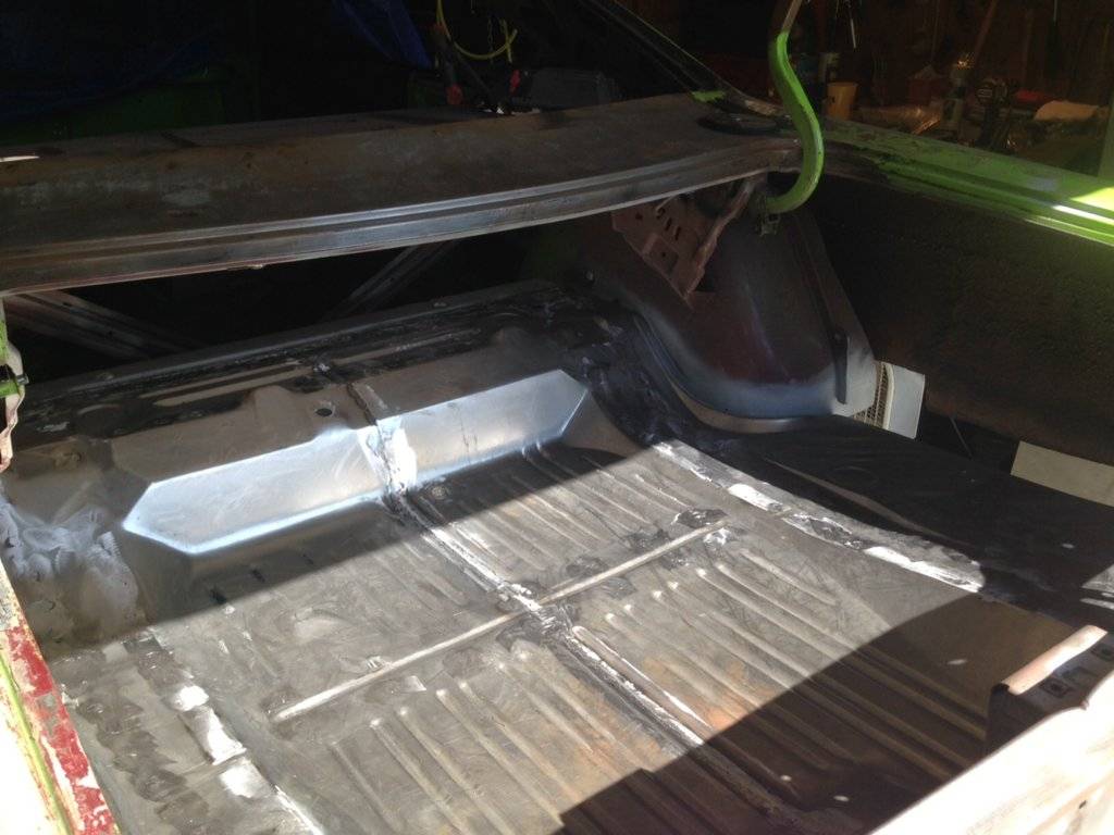

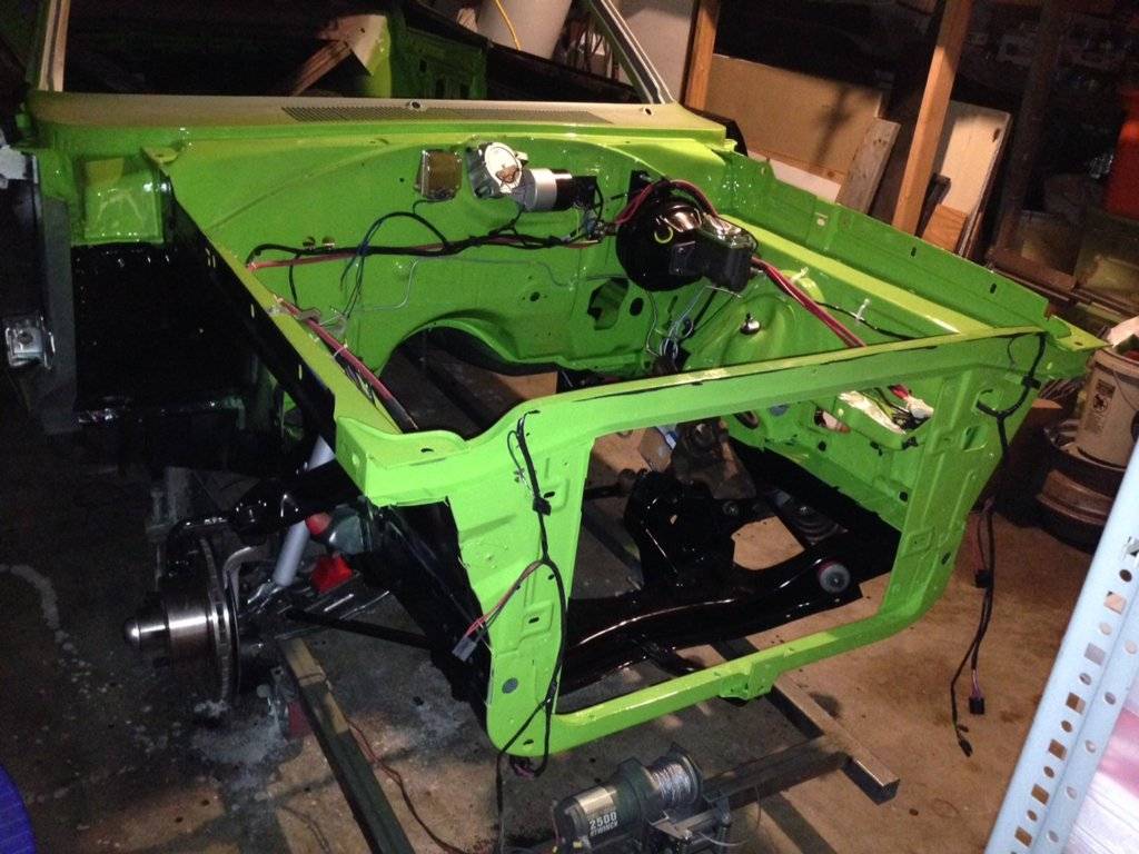

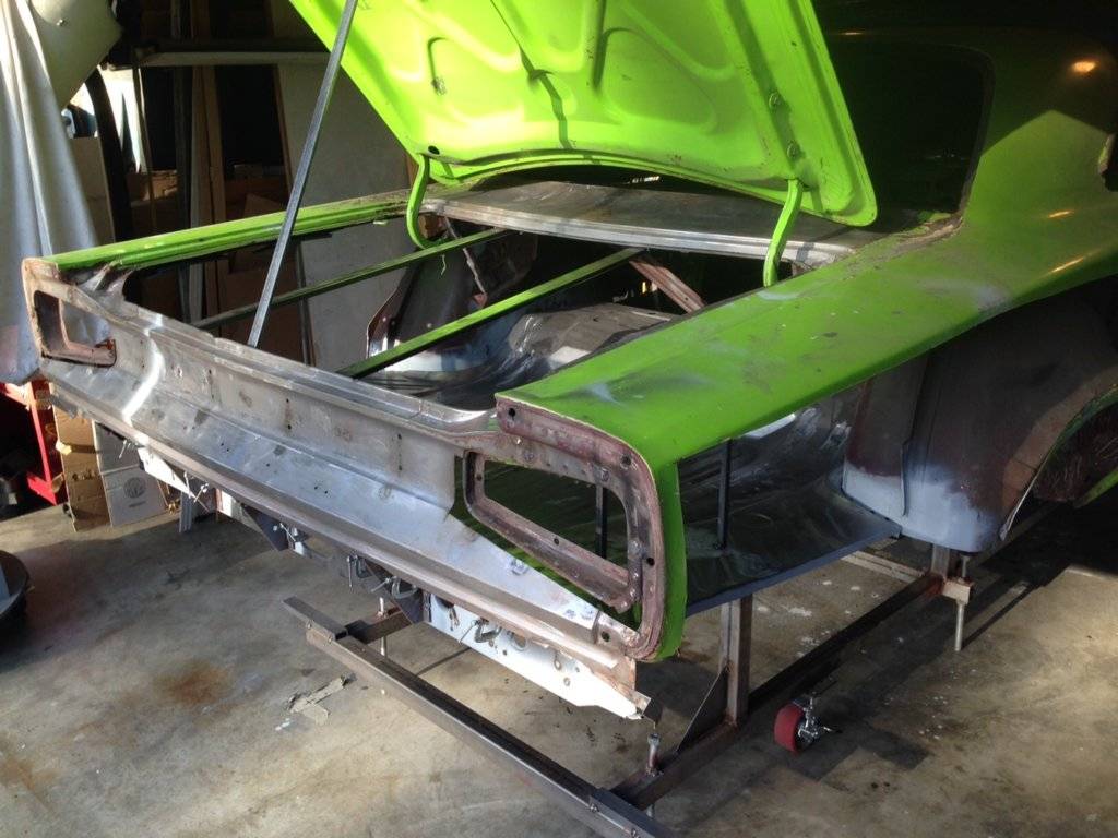

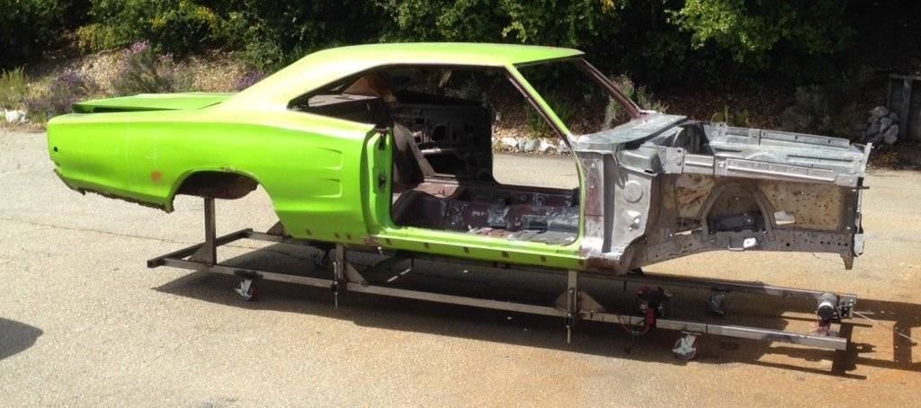

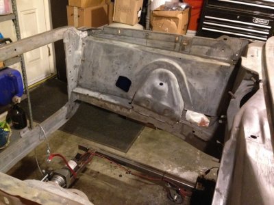

Here are some shots of the body under restoration - you can see why I think it will be another year before it is rolling:
