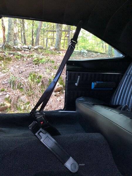

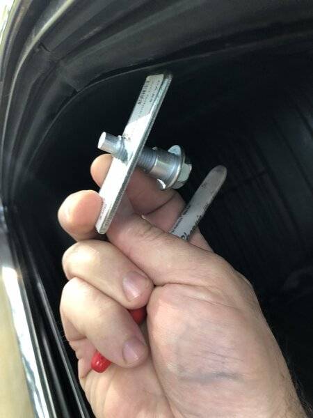

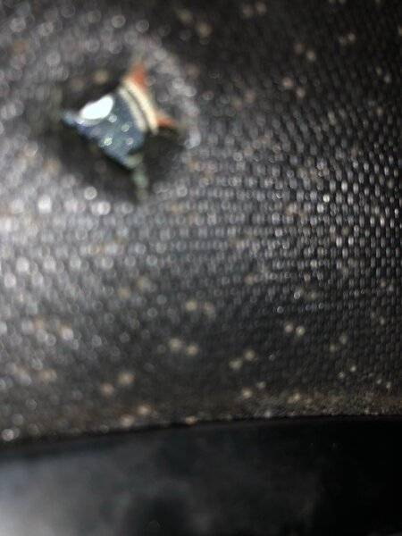

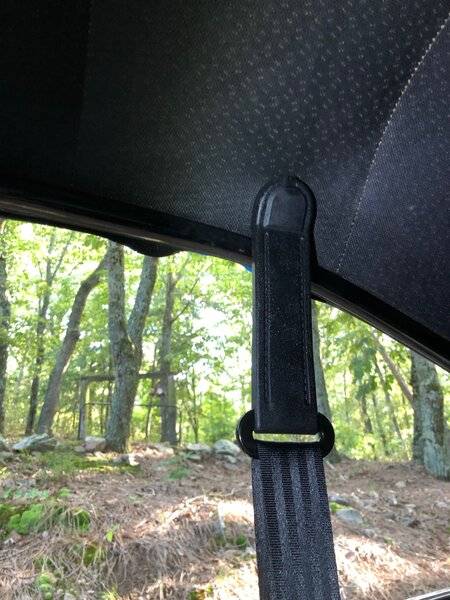

68 and up had the mount but may or may not have the threaded nut welded in. Pic below, feel at the B pillar for a hole. It can easily be felt thru the headliner. Assuming you are going to 3 point, find the hole and make a small cut in the headliner at the center. Peek in and see if you have threads. Yes, you are lucky. No, a backing plate needs to go in. Pic below. Should go in with no headliner, but can go in post mortum without to much pain. Report back an I have pics of the install.

XV Racing for all of the belts. (3) rear lap and (2) front 3 point.
Seatbeltplanet for the anchor plates and bolts. I went ahead and put all new bolts in.
