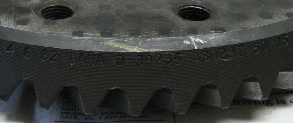

The 3.31 gears are from a Dana 61 that came in pickups and vans,
I would like to see your 3.33 gear set for a Dana 60
The part number and date are on the ring gear. Would be great information.
Tom

Here you go, not sure which is P/N-
