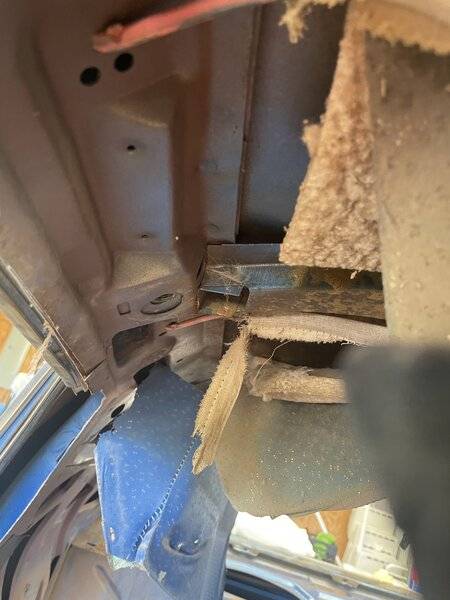

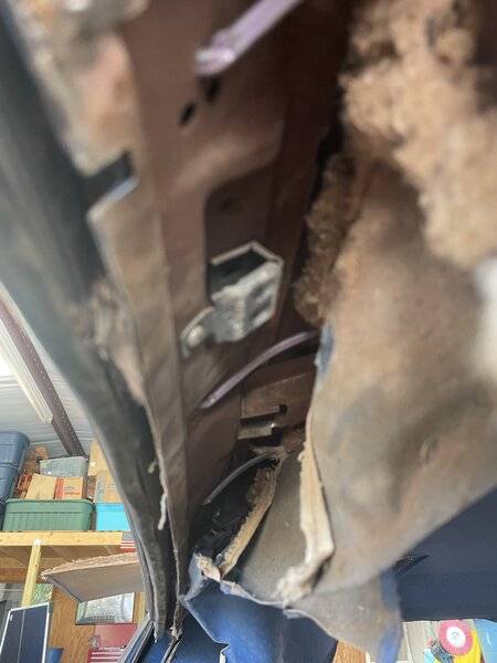

I took my 71 headliner out today. Every bow was in the forward hole of the 3-hole set...not sure if the helps.
Sorry for the less than optimal photos, but I was on a roll and said to myself “hey dummy, you better get some pics!”

What you did here was the most helpful. The holes are about the height of the bow in the roof and not front to back. Test fit the bows one at a time, remember to mark them before removing from the original headlining. I always use a tape flag with a number, wire markers work too.
Try the middle set of holes first and see how it fits. I always try to get them as high as I can without touching anything, and a slight left to right movement. Lightly touching the padding is okay. Remember the hoop in the headlining that the bow slips in, (called listing ), needs some clearance. If the bow is too low, there is a chance one end could come out of the hole after the headliner is installed, not an easy fix. They also don't need to match holes side to side on each bow but I like to try to match holes along the sides. (i. e. middle holes passenger side, top hole driver side, I've seen factory installs like this).
Also make sure the bows are smooth and clean, no rust scale or burs. This helps let the listing slide along the bow when stretching the wrinkles out side to side. Good news is you only have 4 to do.
