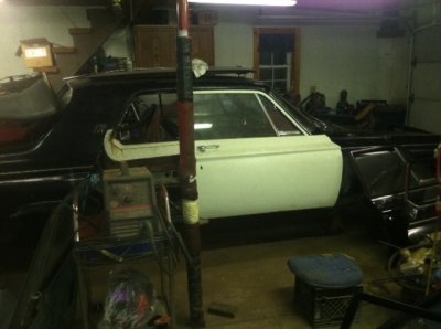

rd off.jpgDr on.jpg Very easy To Do! I have less than 10 hours in my conversion to get it to this point.

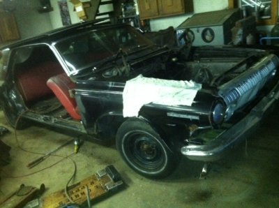

The angle of the windshield is different on the 64-65 making the vent assembly different also.The 63 vent glass is pointed at the top where the 64-65 are more flat on top.The 63 B-body latches and strikers are the same.The 64-65 B-body latches and strikers are the same.Peter I am doing a 64 Belvedere 4 to 2 dr and if you find a good rust free 2 dr sdn over here the prices are not cheap even for just a roller.I am lucky that I have found 3 rusty 2dr sdn donor cars for parts and have taken advantage because the yard is crushing all the cars.The conversion is not that hard if you have the donor parts. People replace quarter panels,trunk floors,trunk extensions,wheel houses,or any other panel that needs replaceed and don't even second guess it. So the conversion is just another area of the car, I say Gitter Done. I have done a lot of research in the 63-65 B-bodies as to the parts that will work and the parts books.Will help any way I can. Also here are some pictures that may help,I have lots of pics. The hdtp doors can also be converted to sdn doors with no problem.

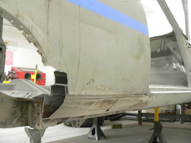

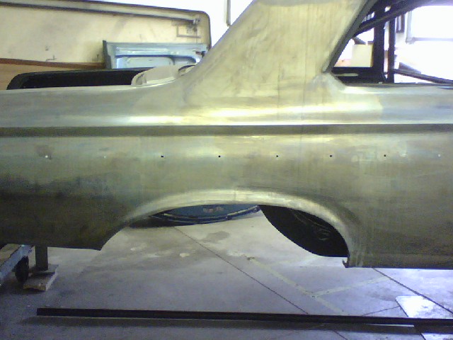

The swap is not as easy as some would make it seem to be. Not if you want to do it right, anyway.

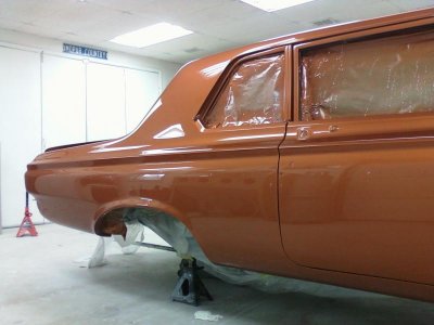

The 2 door to 4 door swap though not simple is not all that big ad deal. Plenty of step by step pics online. I believe the sedan window frames can be added to the H/T doors. The doors aren't exact but can be made to work. Use pieces from the rear door frames to lengthen the fronts. I made all these 1/4 pieces. This was my 1st time making patch panels. I say go for it.
