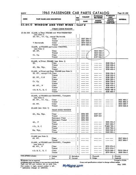

Hi guys, I've got a 65 coronet convertible I'm going to part out and a guy wants the glass, the doors on this car have been changed out. I just wanted to make sure before I sell him the glass that it's the correct glass for the car. So is the door glass on a hardtop the same, or different than a convertible door glass? Thanks for the help
Yes. They are different between HT and Conv. The Convert glass has a curve at the top where the HT glass is pretty straight. I found that out when I tried matching up a hardtop window with my Fury Convertible window. They are different also.
