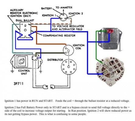

Hi, can you please clarify which wires you are saying need to splice to the thin Red MSD box ? Is it the Ignition 1 and Ignition 2 wires? I ask because I am trying to eliminate the Ballast Resistor on my 1971 Dart. I had two brown wires on the right side of the Ballast and I have 2 blue wires and 1 black wire on the other side. I ALSO have read other posts that go farther and say to also splice the Blue wire form the voltage regulator to the same thin Red wire to the MSD box.

Can you please explain how to eliminate? I have ran mine for 2 years with the Ballast. I want to eliminate the ballast, but not getting the wiring right. My ballast has 2 brown wires on the right (brown with white line) and on the other side is 2 blue and 1 black wire.
Unhook the ballast resistor and find the wire that has power to it coming from the ignition. You should be able to connect your msd directly to that wire and remove the ballast resistor. I think its the blue wire. If there is two blues one may be for crank(ignition 2) and the other for crank and ignition (ignition one). You want the blue for both( ignition one). If the blues are hooked together then it should not matter whether ign 1 or 2 just hook the msd wire to it.

This wire pic may help you. Take the blue wire from the ign 1 on the ign switch and hook it together with the brown wire from the ign switch ign 2. You can unhook the ballast and not use it with MSD and splice the wires right there and then hook the same coil + wire to the MSD box that's 12 volts in the run and start position. Its easiest to just hook them together at the ballast connector because that blue J2 wire also supplies the alt field and voltage reg so you don't want to cut it at the wrong place. You can actually just jump the ign 1 and ign 2 wires (Blue & Brown) at the ballast and then hook the coil + to the MSD. Good luck and ask away if we can help anymore. Ron

I am confused on both because the MSD directions say that I am to connect the original wire that went to the Pos side of the Original MOPAR Coil to the thin Red MSD. According to the wiring diagram that would be the Brown, not Blue.

I already cut the blue wire about 3 inches from the voltage regulator. I cut bot brown wires coming off ballast. It's a rats nest that I created of jumpers and blue spade splicers!
Your picture of the alternator raises another question. One of the wires to the ballast goes to the Alternator.
Ron, fantastic diagram, easier to grasp than the FSM with pics of the Alt & VR. Thanks
