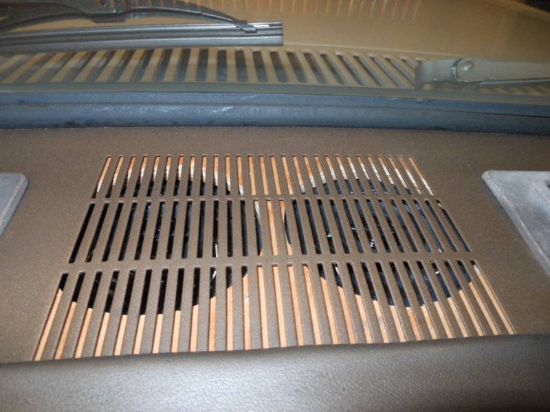

Does anyone know if the 1970 b body in my case a Sport Satellite have a place in front for one or two speakers? Just curious if I could run 4 speakers (2front 2 rear).
Well...you can get a "aluminum dual speaker converter plate" that lets you mount two smaller (3" or so) speakers in the stock, center location where it originally had the one odd-ball long speaker. If you found a car that came with an AM/8-track, those dashes had a place on each side on top for two more 3" or so speakers (in addition to the odd-ball long center speaker). I've looked at maybe mounting some very "thin" 6" round speakers in the door panels under the window cranks or in the kick panels. You can also get some speakers for under the front seats. In the back, don't you have a 6"x9" hole and a different size oval hole (for a defroster) in the back package shelf on hardtops/couples???

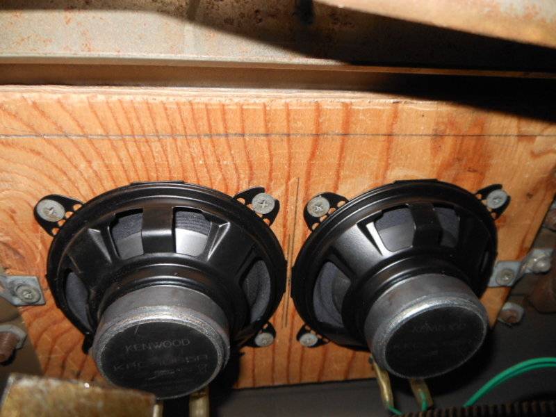

If it helps, I did a two-speaker conversion on my 66 Valiant. It had a single oddball size speaker in the dash (like 5x8 or something?). I made a plywood plate to bolt in place of the speaker, then added two 4" speakers. It works fine and sounds much better than the original blown up version.
