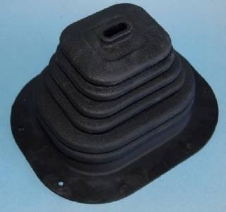

Mine is rubber accordion style, like most of the rest.

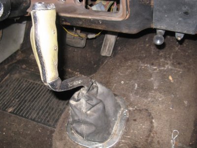

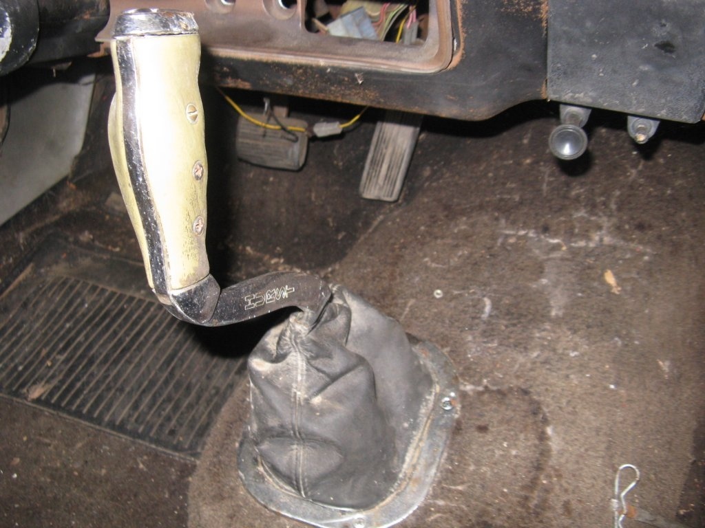

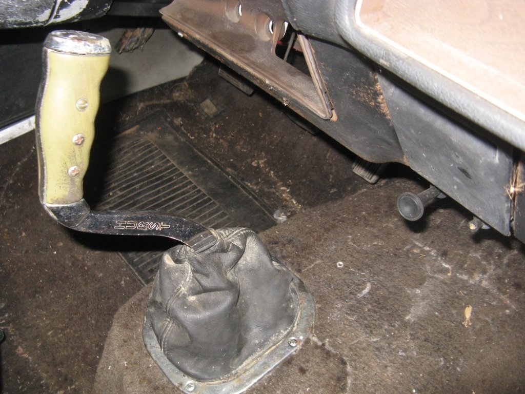

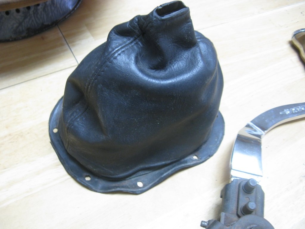

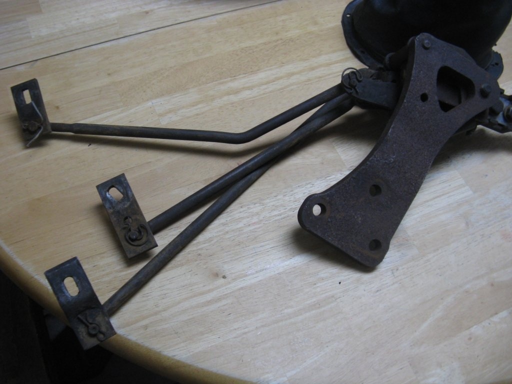

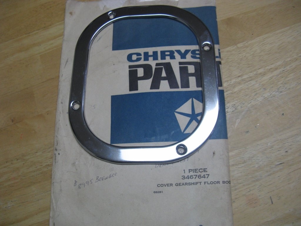

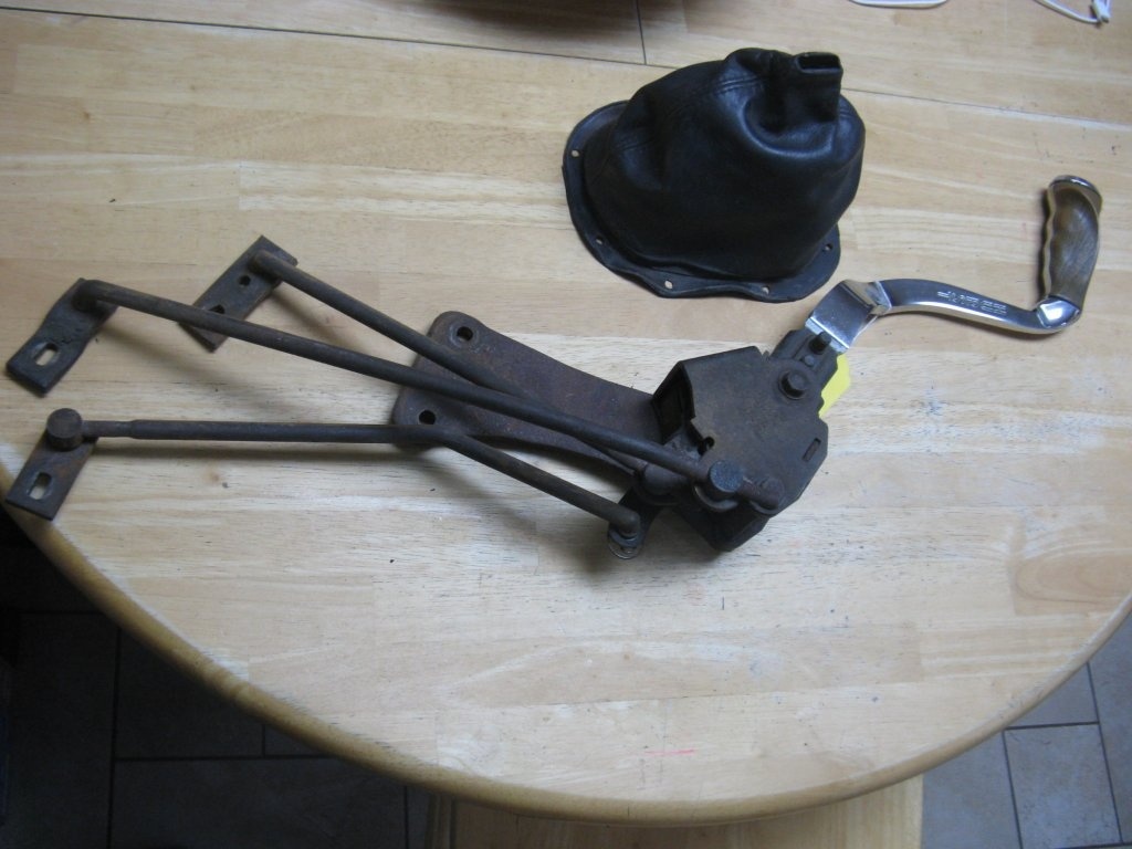

That is a factory original bench seat boot. The reason you don't see many is they did not survive and ended up with something else. Here is an original installed in another car I have...
Yes Mark these are 72-4 boots One is 72 SSP 400 4 speed and the other is 73 340 4 speed... I don't have any 71 only boots I corrected that post. GLNOS had a 71 Boot and it sold for $450. You don't see those or these 72-4 bench seat boots anymore.
They do reproduce the 71 boot. Brewers has them and if I remember they are styled similar but don't look like a real oem 71 boot... They still don't offer the 72-4 bench boots which IMO look much better. Someone with an original 71 boot can show theirs to compare?

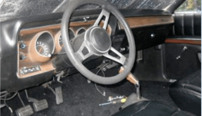

Here are photo's of an 'E' body hump (or bucket seat '74) with short stick and bench seat shift using same hump.
I was told that I'd be shifting from the back seat if I put in a bench seat shifter with an 'E' body mount.

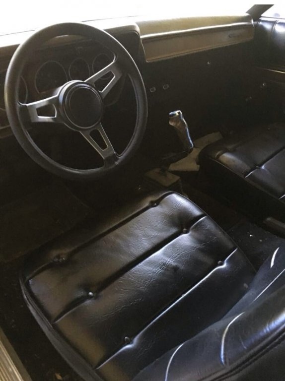

I've managed to acquire almost eveything for this conversion this week. I picked up a trans, bellhousing, clutch, linkage, pedals, and a shifter. I still need to get the bracket that welds to the frame rail, a shifter handle (I have a line on one), a hump and the bezel/boot. My next item to look for is a buddy seat and brackets.
Corrected 72 bench seat with dog leg. Even takes a different shifter boot and ring....
