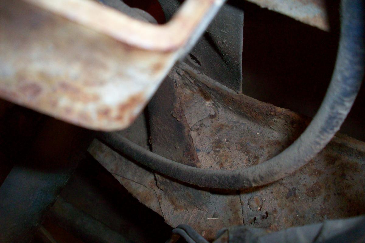

I have converted my 69 b body... On the frame... on the edge, right in front of the z bar service port. you will see a v notch.. it is very clear when you know what to look for. The front corner of the z bar bracket should be right on this v notch. I tack welded the bracket on this notch and installed the bell housing witha core block with the ball stud screwed in to the bell hsg. Yo can then check for proper smooth function of the z bar. I didn,t have to adjust the bracket, the notch is super close for the bracket location. There are pics out on the net that show this notch with the bracket installed. Her is a pic of mine.......

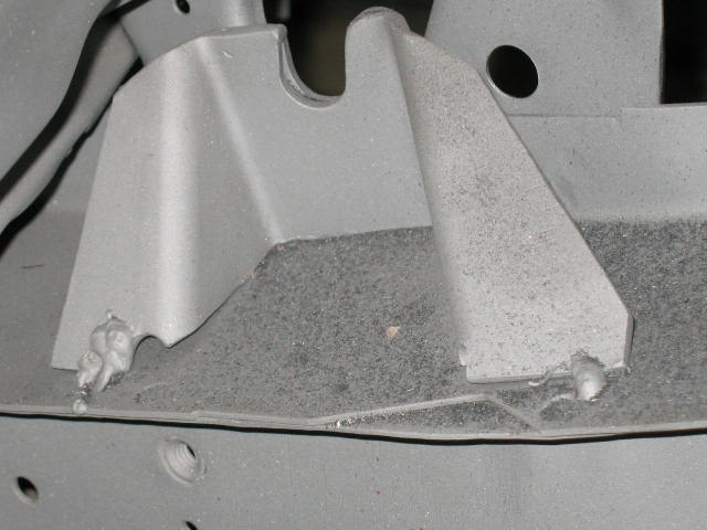

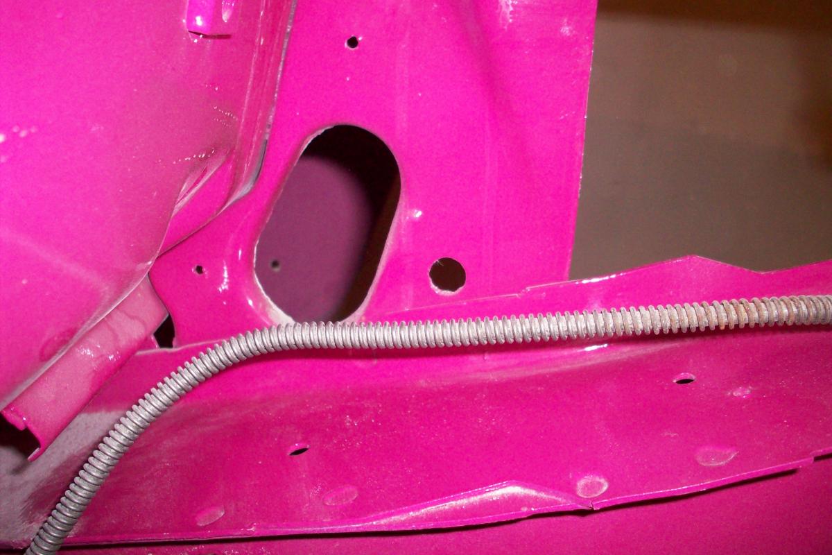

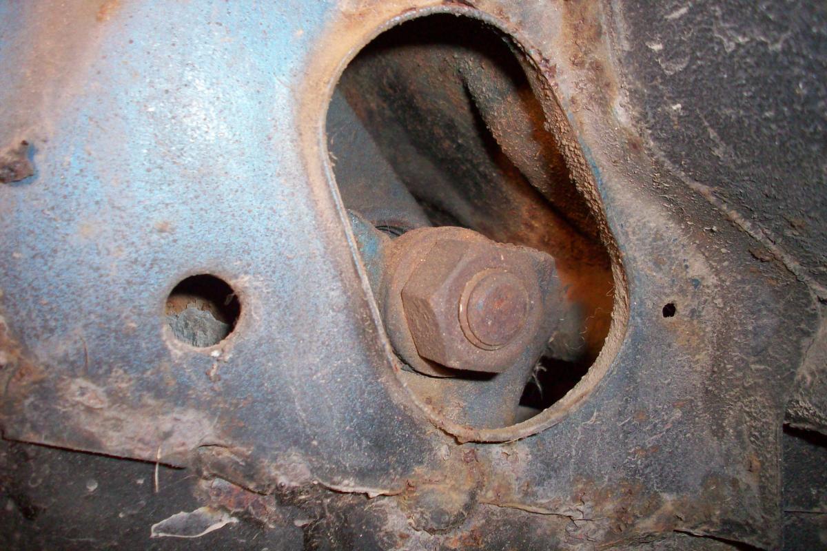

So not that this is any help. And I cant even try to measure through the corrosion but here is some pics i took this morning of my SB 4 spd car and soon to be converted BB 4 spd car.I called Passion and on the new brkt, there is a small tab below the ball stud mt.Set your brkt on the table and it is holding the brkt up from sitting flush. This tab fits down in the same size hole in the frame rail. The hole is rectangular and right below the maintainance access hole.The tab drops in and the brkt sits flush with the rail. Your only other option is to install the motor and bell housing and line it up to weld it. My car doesnot have this hole either,It is all original but it is a convertible, so who knows????

So I installed the bell housing then reinstalled the engine. Mounted the z-bar and lined the shaft up straight accross with the ball stud brkt and marked it.
The bolt lines up with the center of the access hole and the weld points are the same as the picture above. The studs have a ball on the end to pivot. Unless you are way out from the pictures it will work. I moved the brkt 1/4 inch either way and it did not affect the function
