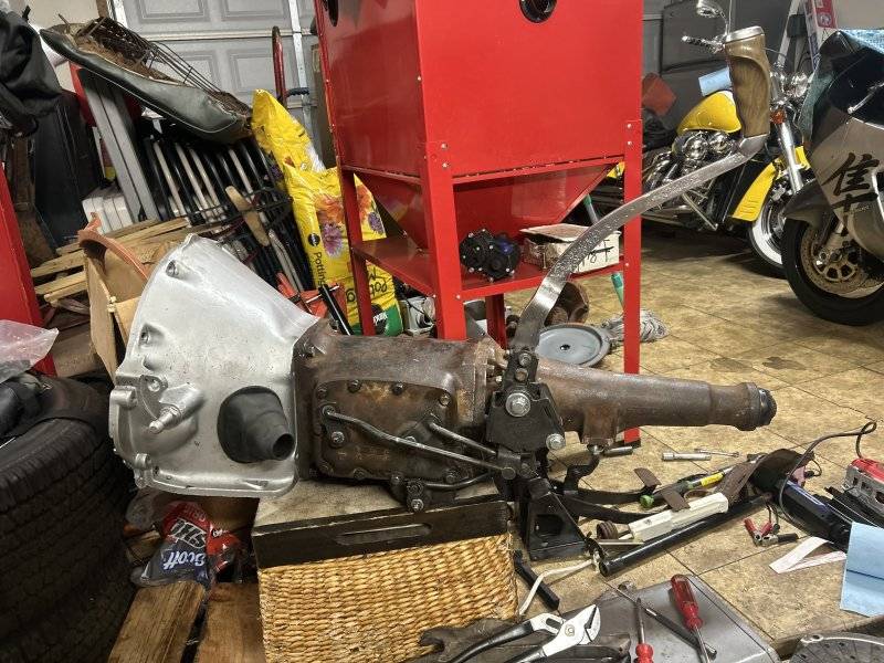

I will definitely have to play with the adjustment a bit more? I’m just not sure which gear or adjustment would prevent me from going into second. I very much so appreciate the advice.
Suggestion.....Standard Hurst shifter adjustment.
1. Remove rods from trans and shifter
2. Find an allen wrench to snugly fit into the shifter adjustment slot/hole at the top of the mechanism.
3. Verify all shifter "fingers" are aligned, and not out of round. Install rods on shifter.
4. Move rods forward and backward to verify there is no slop/movement between rod and shifter.
5. check if the trans side attachment pin and hole in the lever to see if it has any slop.Also visually look at the hole in the trans lever...verify it's not egg shaped.
6. Install and again apply forward and rear ward force to the shift rod. If there is no slop, egged out holes or damaged pins...adjust and install the rods.
7. Don't forget to remove the allen wrench after it's all adjusted.
8. Test drive.
If it's still not right...pull the side cover.
Best of luck...we are all hoping it's an easy one for you.
Edit: and yeah...add 1 solid motor mount..drivers side.

Thank you, I will do just that. This shifter seems to be a universal shifter. I purchased it from an older Mopar buddy of mine. When I go to adjust the linkage with the Allen wrench my rods do not reach my linkage. I have had to connect them normally and make adjustments to shift into each gear without that method. Another thing to mention is, there is slop where the adjustment connects to the shifter. What I mean by slop is I can grab the shifter arm and push it a bit forwards and pull it a bit backwards, is there supposed to be any bushings? IMG_0596.jpeg
