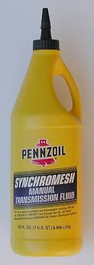

When I had a gear clash problem (1st - 2nd, cold), Heavier oil only made it worse.
Penzoil Synchromesh manual trans fluid did the trick for me.
