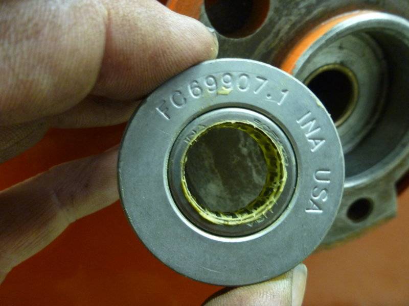

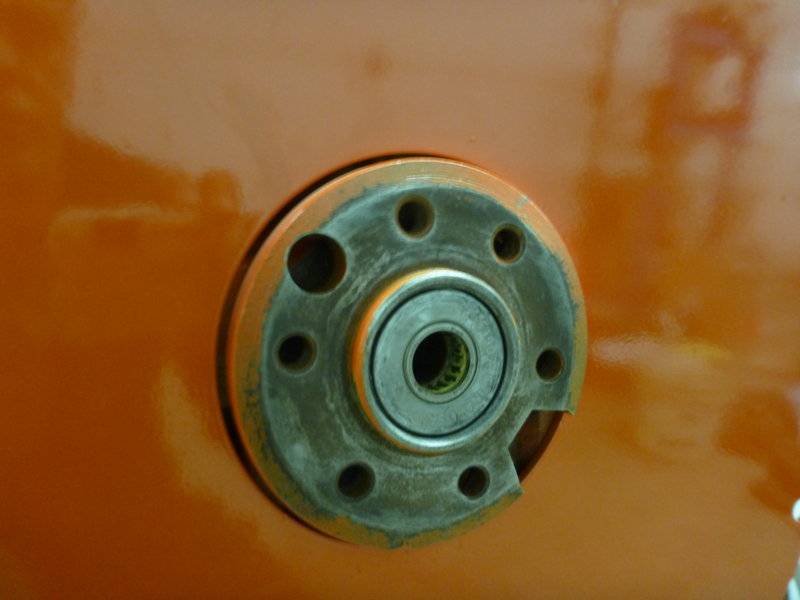

Thanks for the responses but I think I found the issue. Checked the pilot hole for out of round/off set and Brewers was right, the rough drilled pilot hole is not round and probably causing the input shaft to bind. I'm installing a bearing and being done with this. Again thanks for the inputs.
Was just going to say, get rid of the bushing and install the roller/needle bearing.
Did you lube the bushing before installing. It probably burnt of what lube was put on it causing a non lube situation. It takes more than a dab of lube. Remember its going to be there hopefully for a long time.
