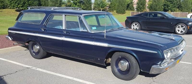

Ok, the wagon is named George, and he has been fighting me tooth and nail.
