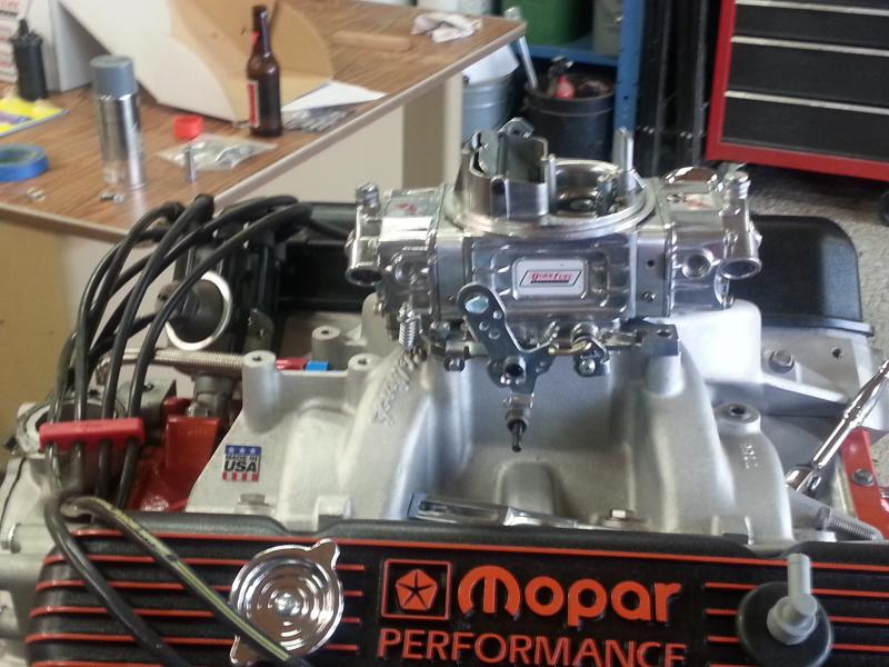

Sounds really cool ... let's see some pics
I think it depends entirely on budget. Stroker (to me) means forget that intake and carb and forget stock heads. Easily will add at the very least $5000 or much more to your engine budget. Sounds like you have the complete motor already, so rebuilding that with higher than stock compression pistons, a nice cam and maybe some aluminum heads will probably get you mid 400 ft lbs of torque. Or you can spend that additional $5000 to $8000 for another 150 lt lbs.
Now that bein said, if none of my parts turn out to be junk, I will have build a budget 451 for something like $4000 out of pocket, but I'm patient and took several years and put a lot of effort in tracking down killer deals.
Of course, you could always find a nice 440 short block and build it instead of the 400...
400 stroked to 470. 585 hp/610 ft lbs of torque
