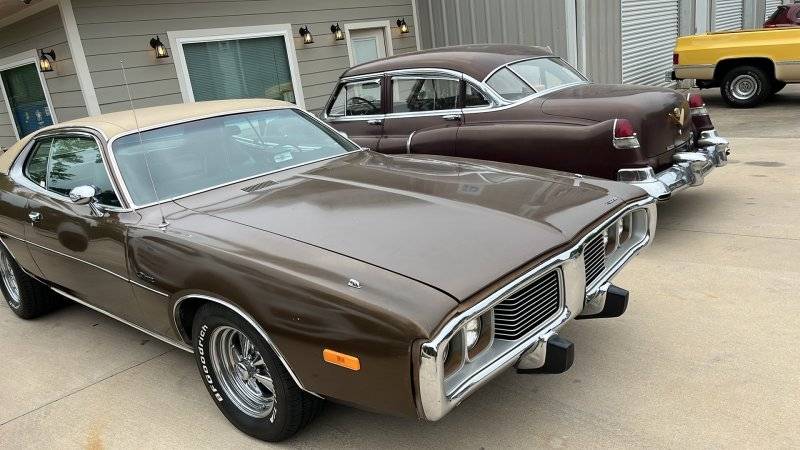

Hey y’all! Got my 73 charger running painfully rich, seemingly. It’s had a Holley Terminator Stealth on a very mild 400bb for a few years, but had never really ran quite right. I’m not tuner, curious if anyone knows anyone in Houston or southern Texas in general that can get this car running right on this system. I’d hate to have to throw in the towel and go back to carb, I’ve invested too much!

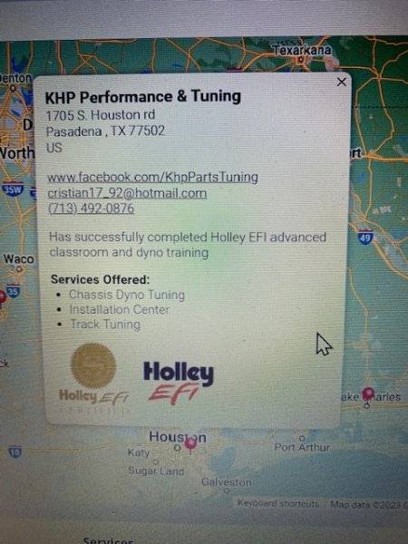

Just did a little more searching.... Might try contacting these folks... I know nothing about them but Holley lists them as an installer...
We've used 'Mad Science Motorsports' (remotely) with excellent results..he's in Texas.
