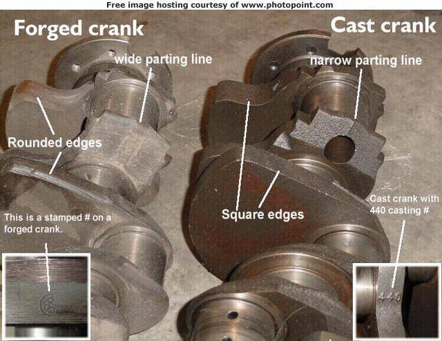

2. Without pulling the pan is there a way to tell if it is a forged crank

OK....so I did a little browsing and saw a picture of a cast crank 400 harmonic balancer and that is definitely what I have. I had the pan off to change over to a truck pan....and I swear that it was a cast crank, but what throws me off is that I also swear that it had a pilot bushing in the end of the crank...I'll have to verify that tonight. I was pretty sure it is a cast crank motor until I saw the statement that all stick shift 400's got the forged crank.
