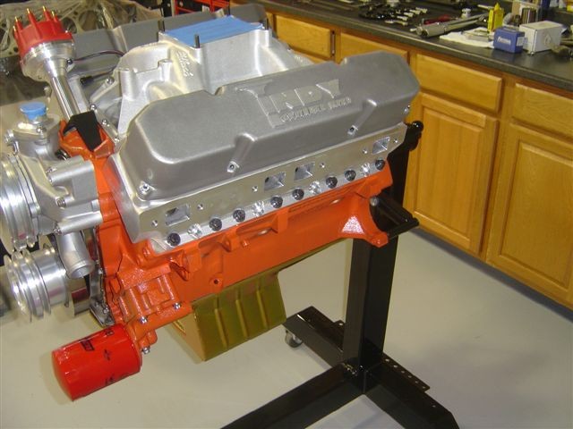

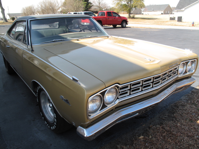

Very good. The car in question is a 1968 Satellite, running a 318 - plan to swap in a big block.
This:
Is going into this:

Nice Satellite and 400, I can't wait to build myself a big block for mine one of these days...

Man, that room is way too clean! Is it used to build engines in or just for taking pics!? :D
