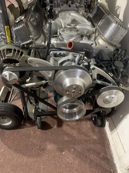

I’ve got the stroker engine mounts on and now I’m working on dressing the front. I am putting the front together and need help finding pulleys. What do you guys recommend or is there anything special to picking them out?
I am leaning towards serpentine and keeping my AC. How many people keep the original ac.
The stroker will be 482hp, 520ish tq dyno’d if I remember right, and I’ll be running FI tech.
Thanks guys

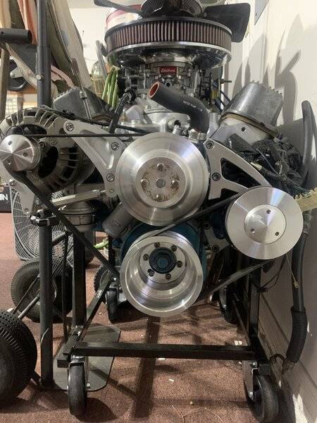

I used the March serpentine set up but I don’t have A/C, just a P/S pulley. There 6 rib wide. (Length I don’t remember.) There on my S/Strip 360. I replaced the bent up OE pulleys since at the time, there cost was only slightly more than repop pulleys. I haven’t thrown a belt since and they don’t slip. Very ez to get at the store when replacement time comes.
You don’t “Need” to use there brackets.”
Looking forward to getting this back in the car soon!
