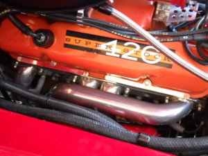

I can't speak to removing the covers with the stock max wedge exhaust manifolds in place, but with headers and bolts, instead of studs for the valve covers, you CAN remove the covers. The top rear bolts have to be put in place and removed with a magnetized 1/4" drive socket and 6" extension.

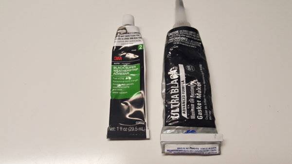

This is what I did for a good seal. I have a pair of old CalCustom aluminum covers that aren't perfectly flat. Just enough that the gasket wasn't making a good contact at the two corners.
Make sure the valve covers are clean and dry.
Apply 3M Super weather adhesive to one side of the gasket and to the valve cover. (I used black so it's not obvious like the yellow.) Then place the gasket in the valve cover and let dry.
Then run a bead of Permatex Ultra Black gasket maker to the gasket. Make sure ahead of time that the head surface is clean and dry. Install the valve cover on the head immediately, install the fasteners and only finger tighten. Wait one hour then properly tighten the fasteners.
Worked great and haven't had any leaks.
