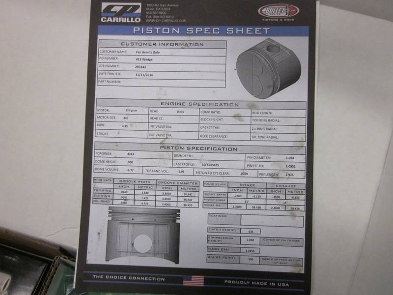

Pistons are a big expense compared to a 440 but I used the 413 anyway. Went with the 73 413 block bored to 4.25. Original forged crank. New ohio hbeam rods and custom carillo pistons. All balanced.
Voodoo 60603 cam.
Have 906 heads on it for now but I'm replacing them with eddys when I can.
glenwood do you know the CH of the pistons and what cranking compression you ended up with?
good choices IMHO I did not no Carrillo made pistons but then it's not the same group I delt with in the 60's 70's
Here's the spec sheet for the pistons. With a CH of 2.060, they ended up in the hole .019 and tested hot at 155psi.
.019 wow I usually get that with 6-pack height pistons
good compression- something you can work with
Even The KB's do not have that high a CH
buying custom pistons isn't difficult, but you do need to know head volume to get the correct compression ratio. wiseco used to be fairly economical compared to some others.
Also remember on those pistons that Carillo makes, the valve reliefs add about 7 cc of volume to the combustion chamber. This is true of most any piston with valve reliefs. But a dome piston from Ross can reduce chamber volume by as much as 14 cc, even with generous valve reliefs.
I've been trying to decide on what head cc to pick. Looks like the eddy 75cc will push the cr to about 10.4 but I'm not sure if this is ideal. The thinnest cometic gasket is .027 which makes the quench or squish at .046. Probably fine I thought the target was to get below .040 on pump.
